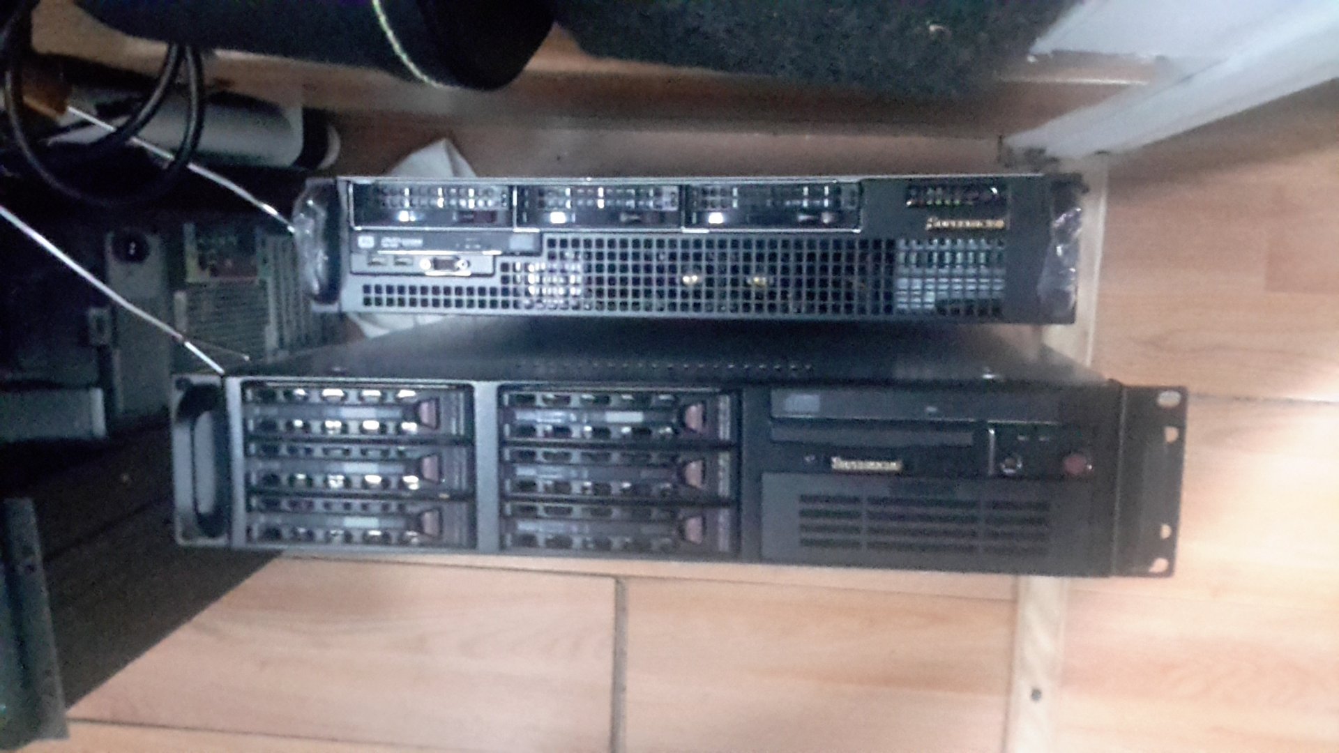

Talking about 2U PSUs, what are you guys using? I got as a gift a 2U SM case with 6 hot swap bays that I'm playing around for future build (the one on the attached pic with a floppy :) )
The case fans are loud as a jet taking off, the PSU fan is almost there. Replaced the PSU fan with a quieter one I had around and the noise level went down 80% and the air flow seems fine. Have anyone done that before? Any 2U PSU that someone would recommend that can be quiet enough to be running in your .... let say ... bedroom?
Now for the case fans I'm thinking on Fractal Design R3s 80mm. Are those a good option? I read they run at 18.1 db, so should be quiet (I hope).
