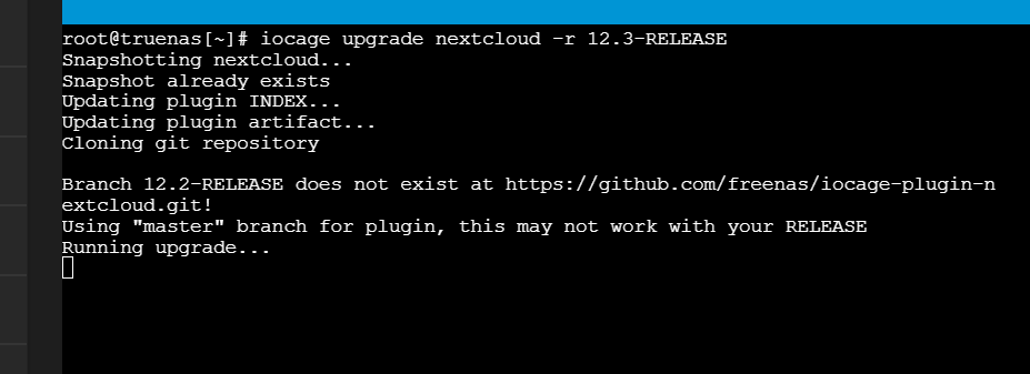

i run the command and this is what it wrote:
and then bunch of "pkg : lua script failed"
Patrick M. Hausen
Nov 25, 2013
7,776
OK ... then you should probably roll back to the snapshot it created and restart. With regular jails this "just works" - don't know why it doesn't with your plugin. Sorry.
