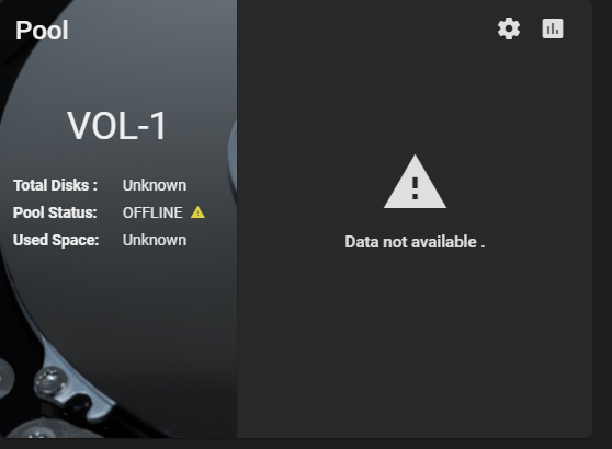

Ah yes, it won't take anything past config" into the clipboard for some reason.
Here is a screenshot
GBillR
Jun 12, 2016
189
Unfortunately, that is not really helpful. There are 2 pools, the freenas-boot pool and your data pool. In addition to the status of the boot pool, you should see the status of the data pool, which in your case looks to be called VOL-1. In any event, what do you see if you select the gear icon of the VOL-1 pool that is located in the upper right of the screen print you provided? Also, please provide your system specs as described in the Forum Rules post. More information is required for us to assist you further...
After clicking the gear icon it takes me to a pool status page with nothing under any of the values.
Paengaroa
May 3, 2021
47
Just seems that all the disks are no longer in the pool. But all of them including the new disk are being appearing in the system under "Disks"
