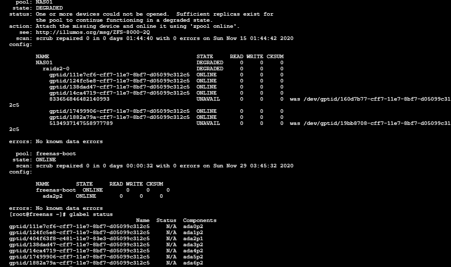

I recently had an issue where two of my drives were listed in degraded state. I replaced them and while one drive was recognized, the other was not.
Hardware/OS:
As a setup I have the FreeNas Mini XL and current operating system level is FreeNAS-11.1-U7. The drives are 6.0 TB WD RED drives. Original hard drive were model WD60EFRX and the new model is WD60EFAX.

1. Ran and it does not show up. Also checked
2. Turned system off. Tried swapping disks around thinking it might be a bad bay or cable. The new hard drive was still not recognized.
3. I had an old WD 160 GB drive lying around and decided to plug that in to see if it worked. It showed up.
4. So thinking I had a bad drive, I ordered a new hard drive thinking it was bad. Got it took the 160GB drive out and put the new drive in and the new drive isn't showing up.
5. Took one of the other 8 working drives out and left the drive that wasn't working in and still did not show up.
Is it possible I just have really bad luck and two drives that I got are bad? Or is there some configuration thing that I'm missing while trying to replace these drives?

Steps I took to troubleshoot:
1. Ran
geom disk list
and nothing.egrep 'ada[0-9]' /var/run/dmesg.boot
Any help or insight would be greatly appreciated.
