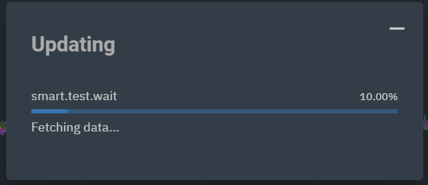

Today I copied more data to the Toshiba pool, and... during receiving data the system crashed (again around 23:53). Now it shows "Last Scan Errors: 18" for the Toshiba pool.
Im running SMART tests on the Toshiba's, but it has been on 10% for the past hour...
My assumption is that one or multiple drives are not ok. Write performance it like 53-60MB/s to the pool, which I think is not right.
So here are my questions:
- The Samsung pool is not healthy, according to the system, but no errors. How can i debug / find out why the system means by it's not healthy?
- What other tests can I do for the Toshiba pool, assuming the SMART remains on 10%?
