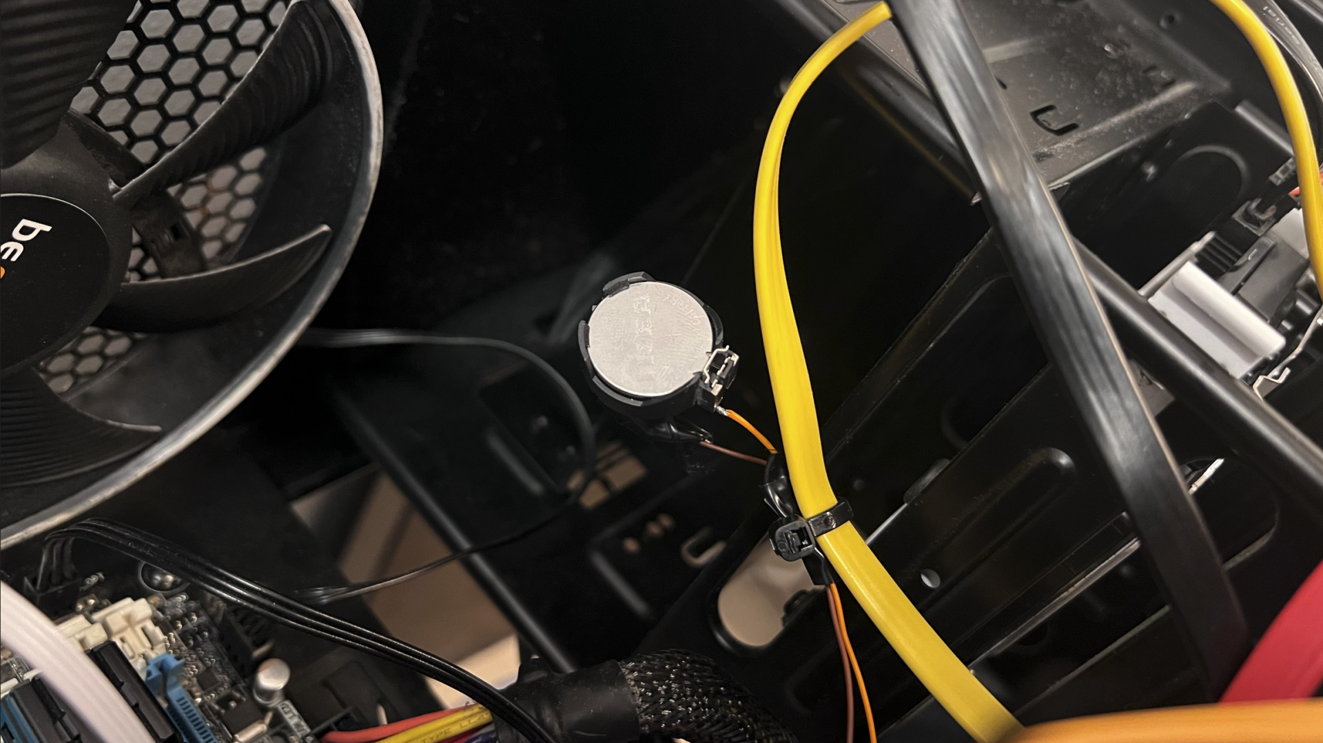

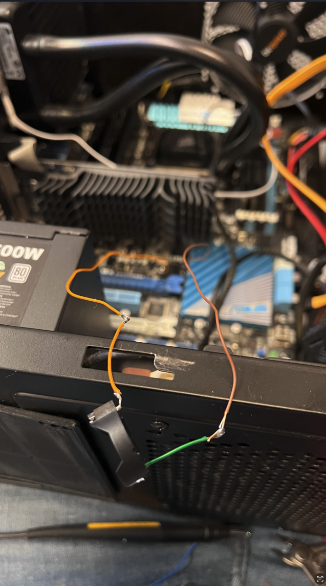

I did, and it still didnt keep time if i plugged out AC for even a few seconds.
So, I ripped the BIOS battery holder off the motherboard, soldered on two wires and made sure all connections were OK.
And now everything works perfectly, it must have been a loose connection there for a long time cause Ive had this problem for years.
Ill attach a couple of pictures of it for you guys' amusement. I can almost hear the facepalm slaps
It would have taken me a very long time to figure out to check the actual connections on the battery holder.
Just out of curiosity: did you solder on wires because you didn't want to disassemble everything and so you could solder without taking out the Mainboard?
Hehe, well thanks!:)
Yes, i didnt want to disassemble everything in order to get to the other side of the motherboard.
And I made the wires long so I could place the battery out of the way of PCIe cards, both to be able to place cards there and not to short circuit anything since the battery itself is conducting.
