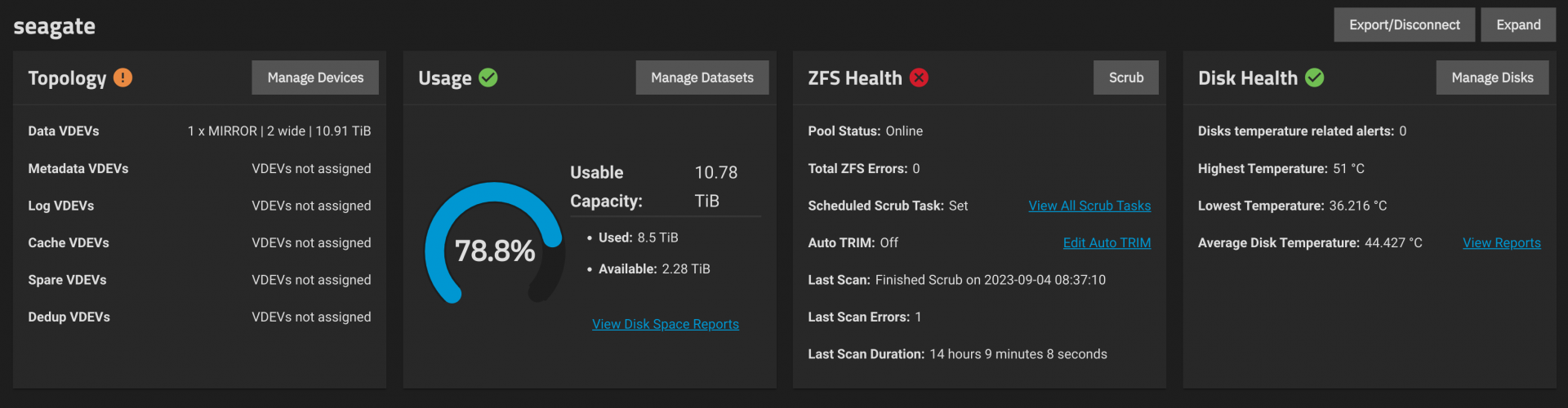

Hi,​
My current system is n5105 celeron 2x12 tb seagate exos (mirror) + 2x8 tb wd red pro 32 gb ram and i am using TrueNAS-SCALE-22.12.0
I've made a scrub for my drives lately and it gave an error during operation but continued now i am seeing this error in my dashboard:
Pool seagate state is ONLINE: One or more devices has experienced an error resulting in data corruption. Applications may be affected.​

it is the seagate one as you can see, should i worry about my drive? i dont wanna do another scrub as it took 14 hours to complete, when i run zpool status -v i see a movie file permanently corrupted which i dont care but my dashboard seems like this and i am worried, what should i check? and how can i remove this error message?

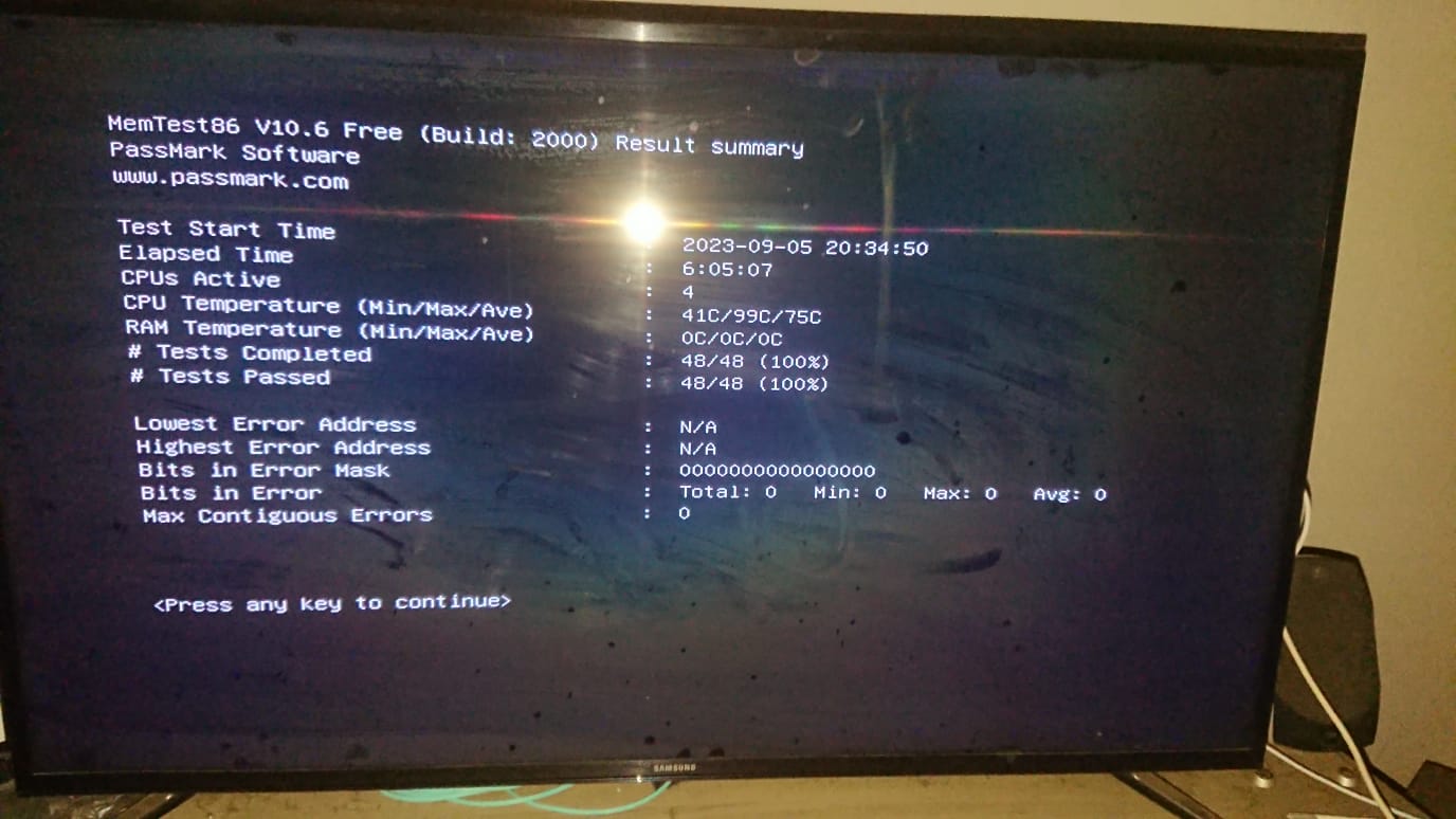

i made memtest but it took 6 hours 15 minutes to complete, choosed option 13 (hammer test) and it passed all 4 test with 0 errors like below;

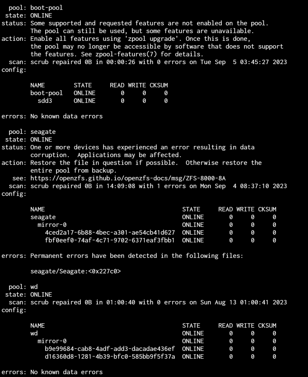

I then deleted the file with permanent error and then restarted but when i check it again with zpool status -v i see some weird 0x0227c0 there with error like below
and it still gives
CRITICAL​
error in alerts and pool status is still unhealthy
Etorix
Dec 30, 2020
2,134
This is an issue with metadata. Short of diving deep into raw ZFS structures (BIG ANGRY DRAGONS AHEAD!!!), the only way to repair is to destroy the pool and restore from backup.:frown:

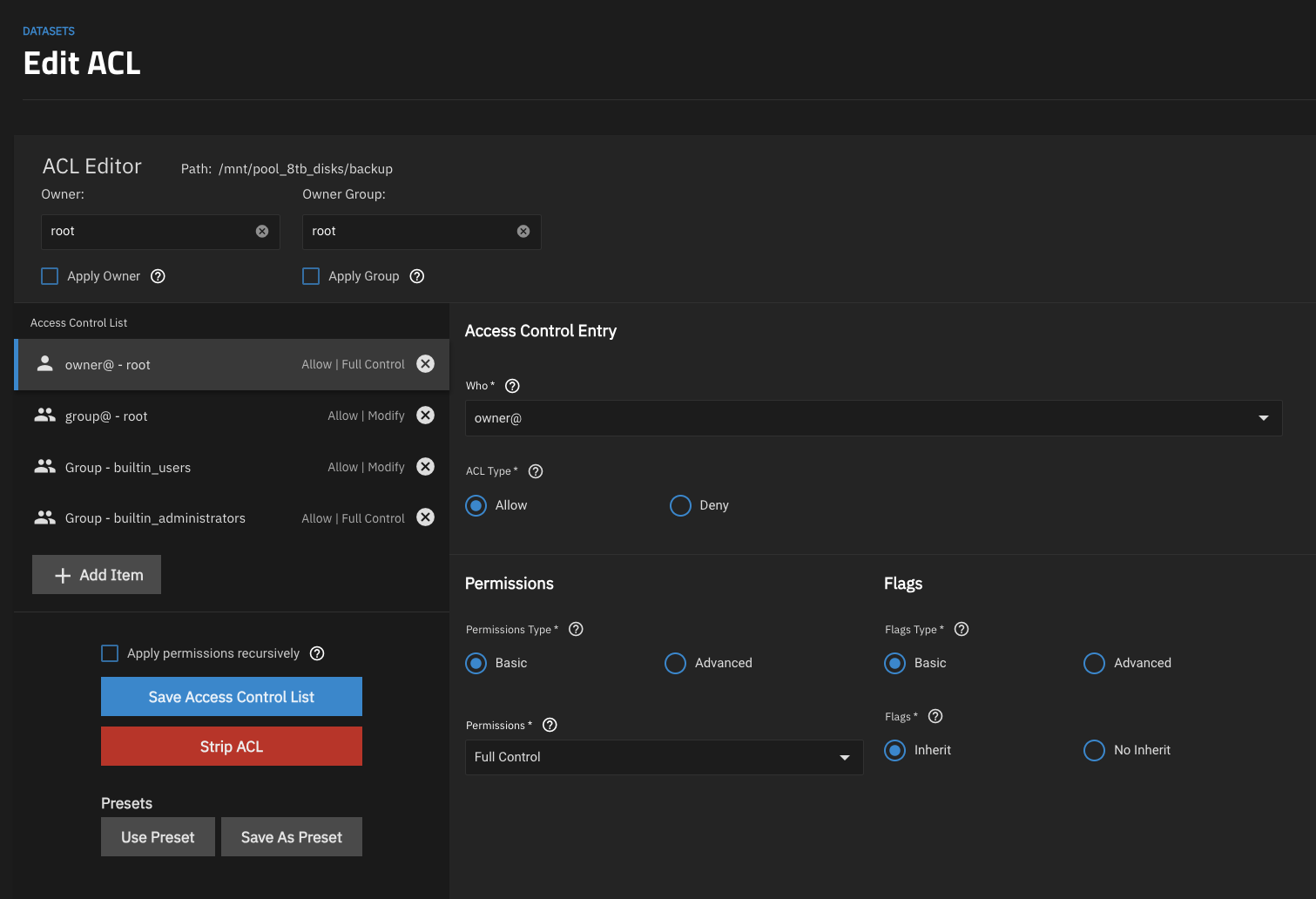

That's because your target for cp probably has dataset aclmode set to restricted.
sfatula
Jul 5, 2022
608
You beat me to it, was just posting that! It's a permissions issue one way or another.
intercom
Sep 7, 2022
21
I figured it was some permissions issue, but I dont understand anything out the ACL setup. I made a completely new dataset on the target drive that looks like screenshot below. How does that look to you?
