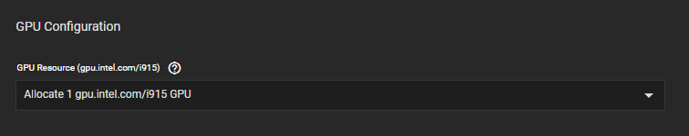

Sure! When you deploy the App, take a look at the GPU section and make sure you have it set to 'Allocate 1' like this.
On the Plex side you may need to check your settings as well, ensure that it is trying to use the GPU after that point.

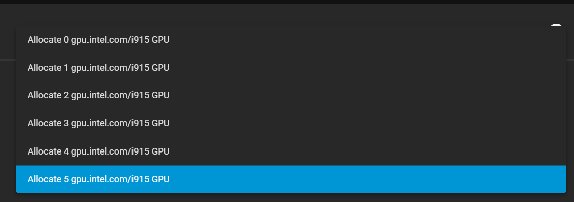

can you please elaborate on why there are up to 5 (in my case) and if adding the 5 will improve performance of the plex app when transcoding?

Checked with our team, but that is a way to handle time-sharing of your GPU between Containers. So you would assign GPU 1 to container 1, GPU2 to container 2, etc etc.

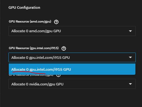

I know this is an older thread, but I'm having the same issue. However whenever I'm editing the plex app, theres nothing to click there. What am I doing wrong? I have it enabled from the Plex dashboard. I dont see any option in my bios (on an S1200RPS) pertaining to Intel Quick Sync
*TrueNAS-SCALE-22.12.3.2
*Truenas charts plex official 1.32.4.7195_1.7.52
*Intel(R) Xeon(R) CPU E3-1275 v3 @ 3.50GHz (supports intel quick sync)
I tried playing a 4k movie earlier down to 1080, and cpu hit 100% load and got up to 85 ...It's like all the options to GPU configuration are just greyed out. I feel like this is something dumb that I've just wholly missed.

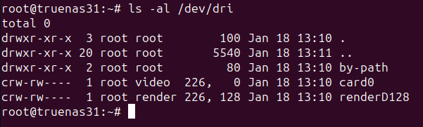

That makes it sound like the onboard GPU isn't being recognized for some reason. Check /dev/dri/* and see if you have any devices there, and I'd suggest reviewing /var/log/messages to see if there are any messages at boot-up from the kernel about DRM/DRI not being able to initialize.
> cat /var/log/messages | grep i915
Barring that, you can open a bug ticket for us to investigate, but first thing to do is see if the kernel even recognizes that Xeon as having built-in GPU/Quicksync.

I just updated to Cobia recently and it was working fine for about a month but today I updated to the most recent version of cobia and my plex stopped working.
I noticed when I tried to update Plex to get it to work I got an error:
"values.gpuConfiguration.gpu.intel.com/i915: Invalid choice: 1"
So I went in and edited the GPU resource for intel to 0 (noticed there was no option to set it to "1" anymore)
Does that mean I can no longer use quicksync for some reason? Is there another way to set this? I dont have a video card I only use quicksync on my CPU. This is my only option now...

That is strange. Recent updates haven't touched the GPU drivers or anything. Still using quicksync here as well. Is this setting only missing on Plex, or do other apps also show "0" for Intel GPU?
oldmichael
Feb 27, 2023
9
Actually I never tried to look cause I wasn't using the iGPU for anything but Plex before (maybe I should be?) but regardless, I just checked two other apps and I only have that one option "0" ....
Kris Moore
SVP of Engineering
Administrator
Nov 12, 2015
1,471
This sounds like the DRI device went away. Can you check if the render devices are available still?
