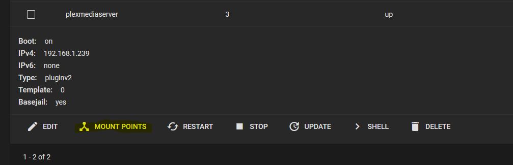

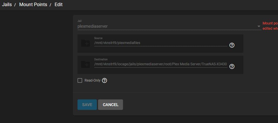

Yes - but bear two things in mind.
1. You have to set up mount points to mount the existing media into the TN jail/docker

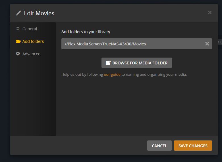

2 things need to be done:
1. you need to define mountpoints in the jail
2. You need to add the directories to your library in Plex
