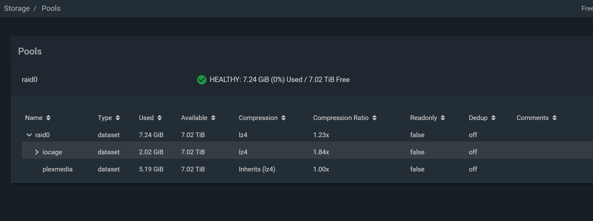

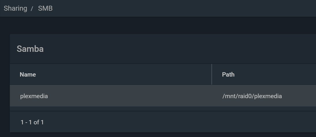

Hi Guys,
I have previously installed Plex and got it running without any issues. Everything was fine up until my power supply blew and lost my HDD's. Now I got everything back online and running, Plex is installed without issues. But when I want to mount my media, the File is grayed out.
I watched the FreeNAS 11.2 - Plex Media Server Plugin YouTube video to make sure I did not stuff something up but everything is sort of the same, except the folder and files naming on my side. I have watched multiple videos but still have the same issue.
I think that there is something small that I am missing but cannot figure out what is going on with this.

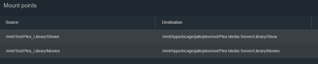

Ok so I figured out my issue! I hope this helps you too!
I accidentally stumbled upon by just trying a lot of different ways. I had to create a mount points. I don't know why that worked but it did!
I like FreeNAS but the UX needs some work. Maybe they need to use something like intro.js to explain areas of the OS better.

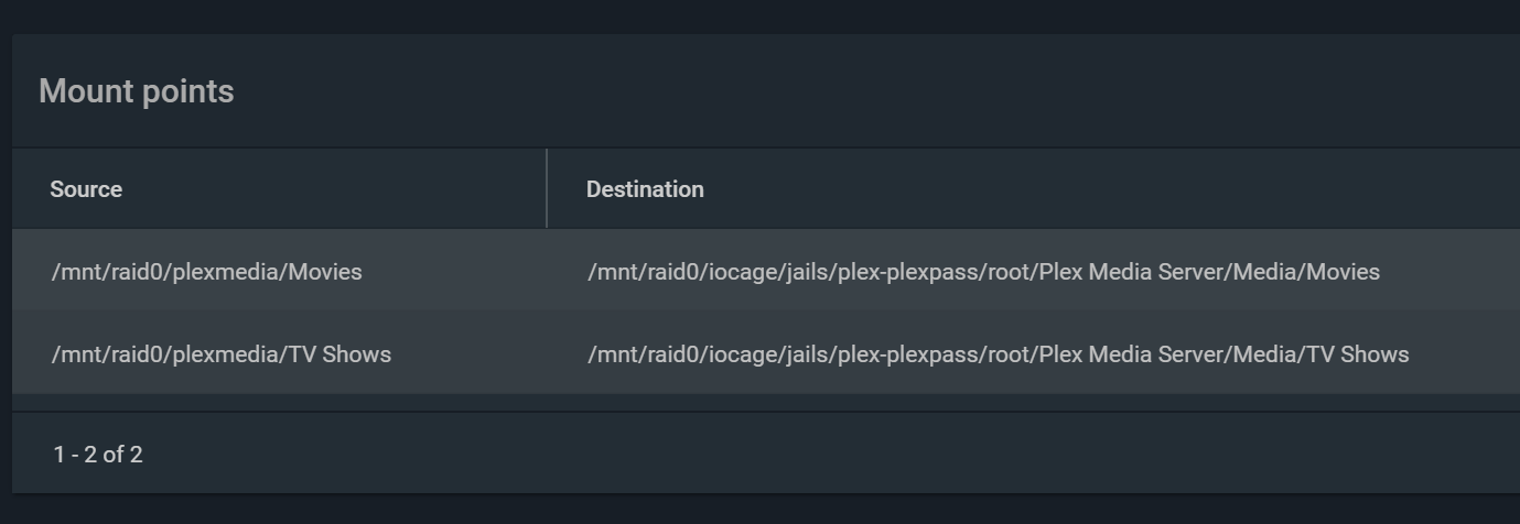

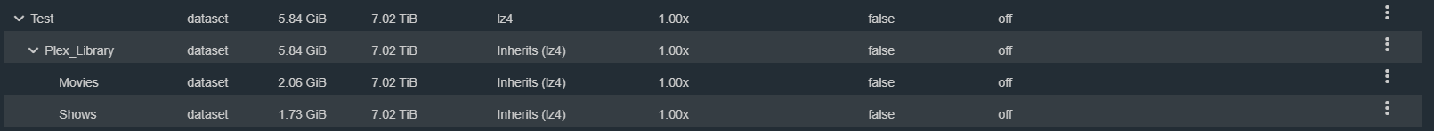

It finally works and here how I did it, for an obscure reason, I could not select folders created into my share like movies and TV shows for instance.
Si what I did was to create two other pools into my Plex pool, like this
Then went to the Jail and set two mount points like this :
It might work wit one mount point, this one being the principal pool but I've not tested it, I think It should work, if someone tries it would be nice to leave the info for future reference.

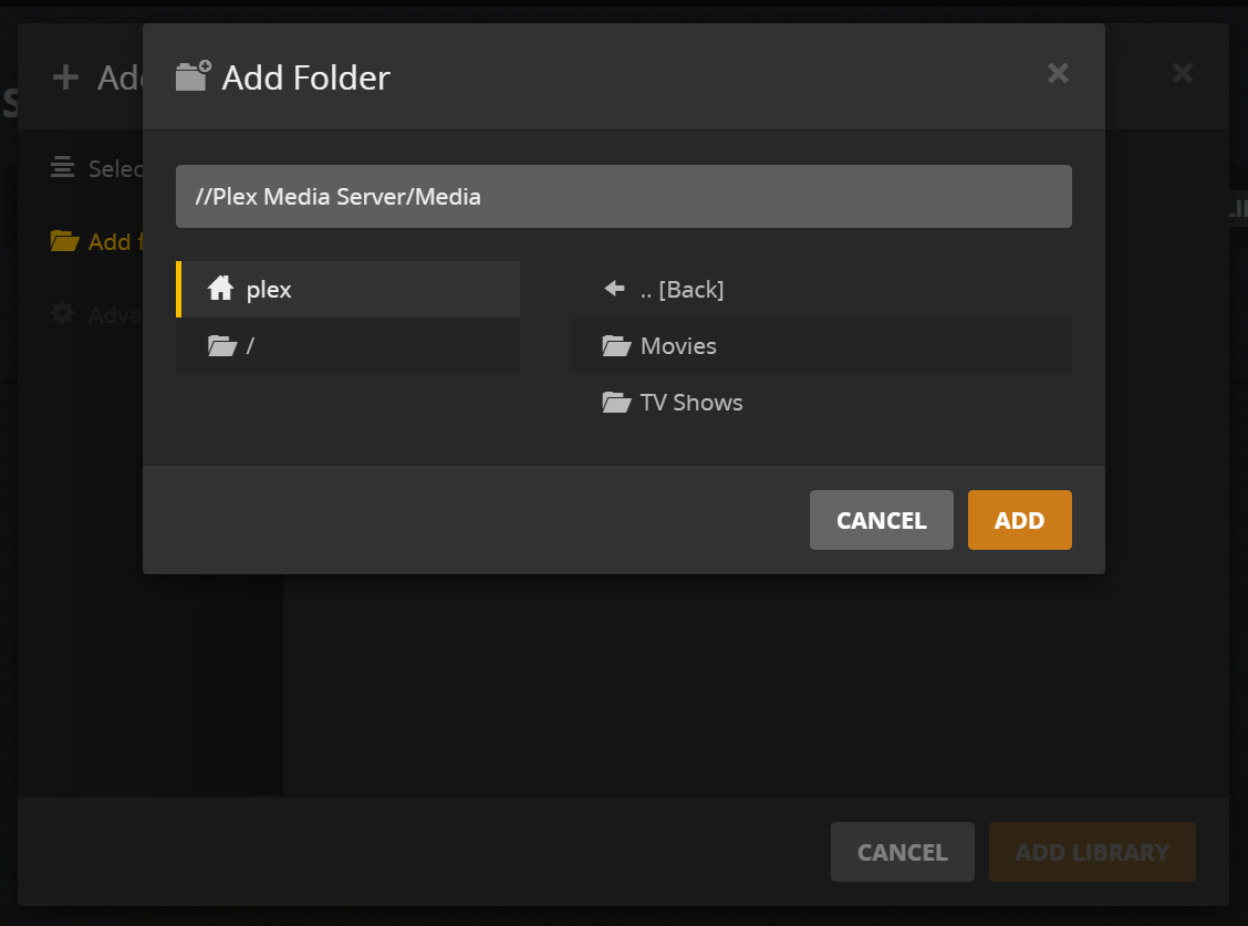

When a jail or plugin is created there is a directory within the jail called /media, it is empty. When creating a mount point for my Plex library I use this directory as the jail target for subdirectories of the library. So my destination mount points are ....../media/movies, ......media/tvshows, etc.
Each of those subdirectories have a dataset on my main pool which are the source mount points.
After I have created the mount points I enter the shell of Plex jail and enter the command “chown -R plex:plex /media” without the quotation marks.
When adding a library in the Plex GUI it is not possible to browse to the /media directory so you must manually type the path to your subdirectory, for example /media/movies.
In addition the full path to you destination mount points will be ... iocage/jails/plex/media/...
I hope this helps.
So this is because you have set up a dataset each for /media and then the underlying subs /media/movies, /media/tvshows..
You can't traverse across datasets when directory listing in this situation;
For example in the /media dataset, if you were to create subdirectories xxx and yyy, then upon listing /media you would see /media + /media/xxx + /media/yyy because they are subs within the same dataset. You would NOT see /media/movies or /media/tvshows, because they themselves are the root for their own dataset.
In this instance you have to create mount points for each dataset and refer them accordingly.
My setup is similar, I have /mnt/vol1/Media/Movies and /mnt/vol1/Media/TV_Shows which have targets of /mnt/Plex_Media_Movies and /mnt/Plex_Media_TV_Shows accordingly. Your films etc will of course be in normal subdirectories, and thus accessible from your mount point.

When creating a single mount point, Silverback was correct, plex cant browse to individual folders when you try to add a folder, it can see them and access them, just for some reason you cant add it using the GUI, so you have to add manually, ie \media\Movies. I have been meaning to log a ticket on this, because on the older versions of Plex/Freenas you were able to do it, not sure if its a plex or jail/freenas issue?

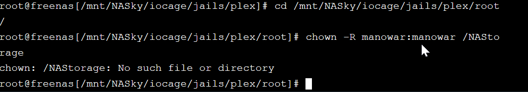

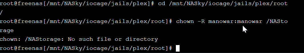

Am i understanding this right, he said: "...I enter the shell of Plex jail..."
Like i did there, but it says, no such file or directory.
Or am i being a retard again?

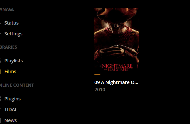

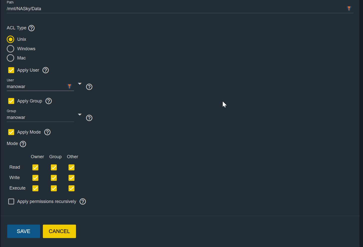

OK, i was able to scan a movie!
BUT
only when i opened the datasets permissions weide open setting ACL Type on UNIX.
But now i can access it from Windows to add more movies... so i have to change it to windows, move all my stuff there and change it back to UNIX?
Do i have to do it every time?
Setting permissions through "chown -R " didn't work as you can see.

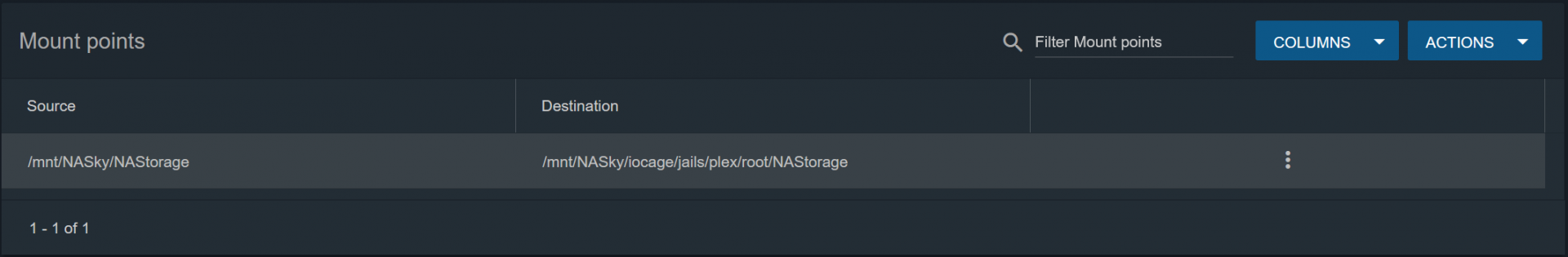

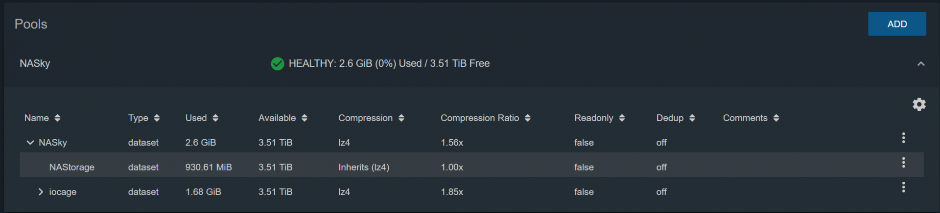

Jailer
Not strong, but bad
Sep 12, 2014
4,977
Damn, is there an alternative to FreeNAS that has an easier setup to PLEX, all i want is to have my Movies on the nas, so that i can watch them on my samsung tv, without turning on my powersucker of a main PC.
You're executing that command at the root level, that's why it's not working. Enter the jail shell jexec plex csh and run chown -R plex:plex /NAStorage. That will give plex ownership of the mount point you created inside your jail.
