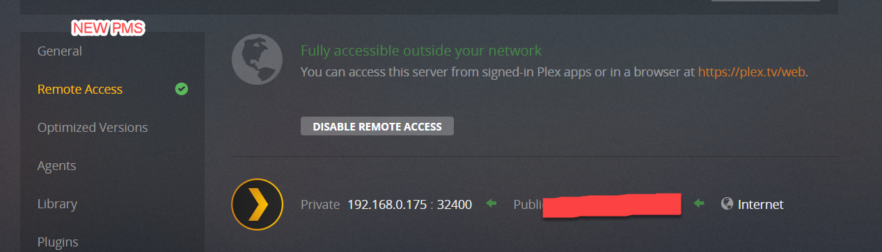

  3. I set up a NEW Plex server on the same FreeNas box and it IS accessible remotely. So the server seems to work but just not with the old installation

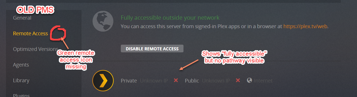

So here's the plex interface of the old PMS
And the new PMS

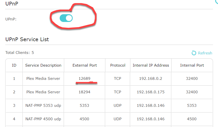

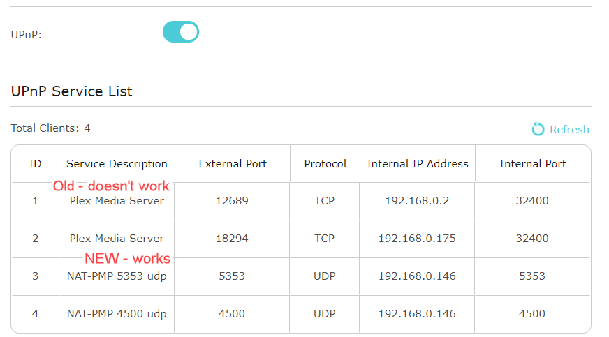

Here's the router interface showing that both Plex servers are automatically configured to allow outside access

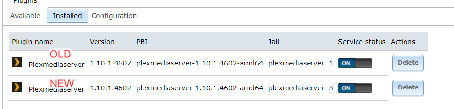

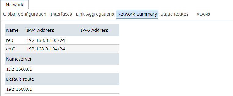

Here are a few screenshots of the FreeNas interface
Both plug-ins are "on"

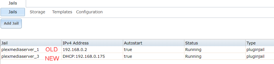

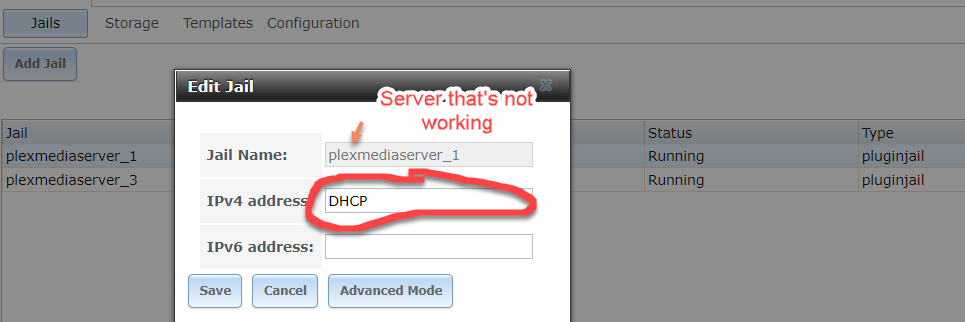

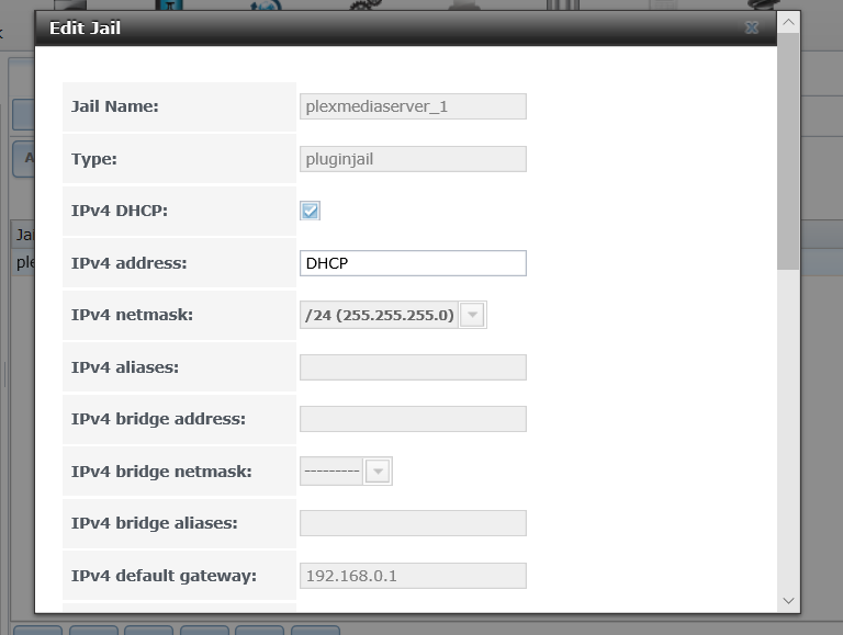

Both JAILS are 'running' but the new server jail IP is different

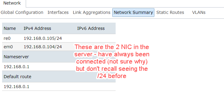

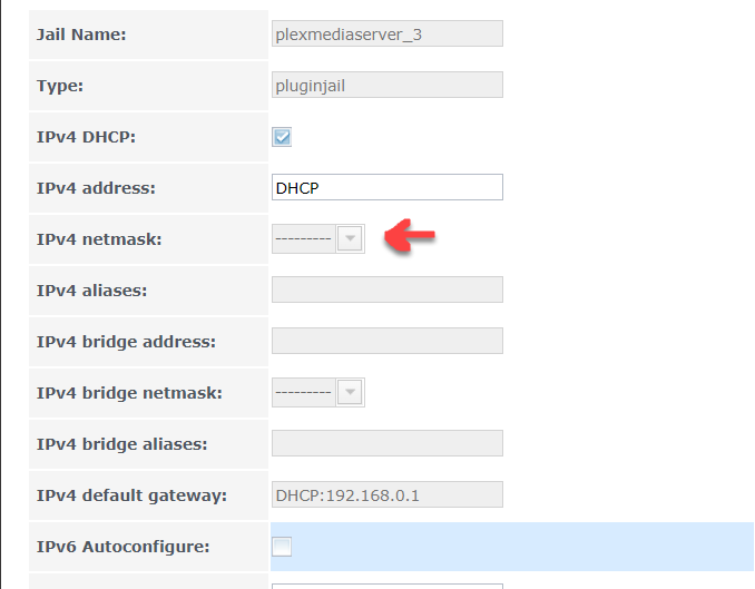

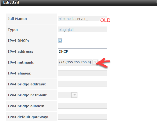

Old PMS jail config - the /24 (255.255.255.0) is not present in the new PMS jail config and I can't remove or change it

A couple of things. You are running a very old version of FreeNAS that is no longer supported. You should upgrade when you get the chance.

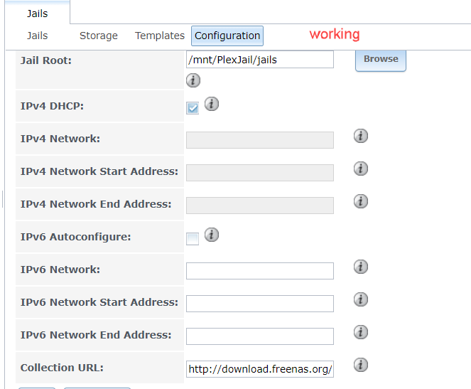

Secondly, can you take a screenshot of the jail configuration settings of the one that is working? Compare the two and see what is different. That will point you in the correct direction.
If I had to guess, your old PMS jail is set to DHCP and didn't get assigned the the IP address it had previously, so that port forwarding rule you have setup on your router is no longer applying. You hold uncheck DHCP server for any jail, assign it a static IP, then make sure your port forwarding rule is pointing to that static IP.

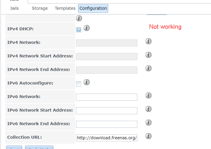

Thank you so much for replying. Point taken about the older version of FreeNas. So are you saying if I upgrade to FreeNas 11 (which I believe is the new version) it might rectify things?

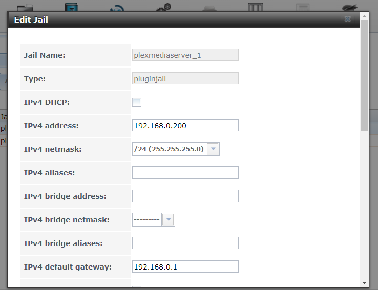

Regarding the configuration screenshots I don't see a difference
This is the config of the server that IS working
Regarding the portforwarding comment you made, the system automatically set that up as pasted earlier (UP&P is enabled which as I believe allows a plug-and-play configuration to automatically take place). Regarding your suggestion, are you suggesting I place a static IP instead of "DHCP" here (say 192.168.0.200) .....

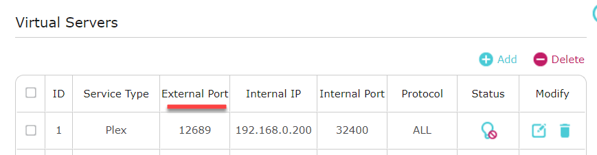

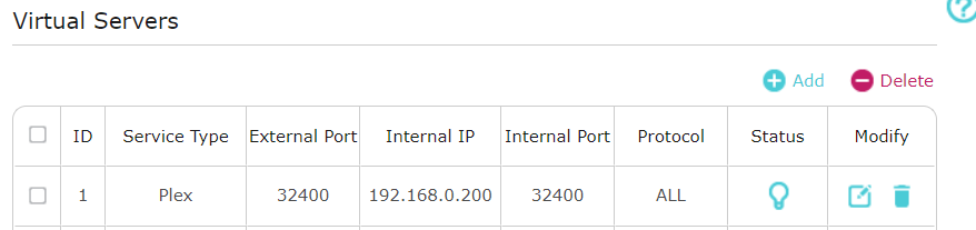

And then set it up on the TP link router as a "virtual server" as below:
Does that sound correct? For "external port" I picked 12689 from the UP&P display which gave this number to the Plex server that's not working (see below). Is that correct?
Also, once I do this (assuming any of the above I've written is correct) do I disable the "UP&P" option (see above)

No I would sort out this issue first before upgrading. But after this is sorted out, I would personally upgrade.

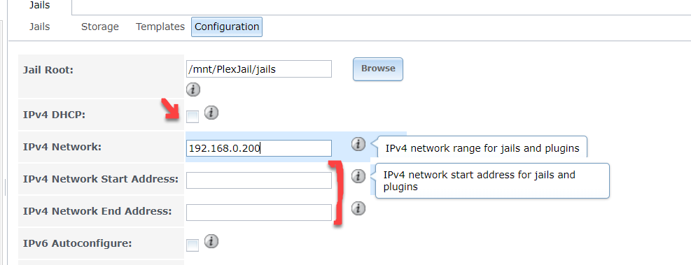

Yes. Uncheck DHCP, set any static IP for your jail that is within your router's range. Then go to your router and create a new virtual server with the correct parameters. Should work. And you don't need UPnP on. Turn that off unless you are using it for some other purpose.

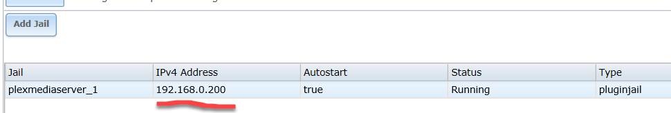

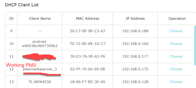

Also, when I go into the router I find that the router has assigned a DHCP IP address to the new WORKING PMS but there the now non-working PMS has no mention and no IP assigned to it.
Do I have to assign the non-working PMS (plexmediaserver_1) a static IP (say 192.168.0.200) at the router level also and if so, how do I manually enter it (I mean to say, do I just copy the MAC address for the plexmediaserver_3 (new working PMS) because it's likely to be the same?

Thanks so much for your prompt reply. So in the jail config I uncheck DHCP but bit confused as to what to enter in the 3 ip4 rows. The static IP 192.168.0.200 should go where? Then it's got a start and end iP address do I put the same 192.168.0.200 in all three rows?

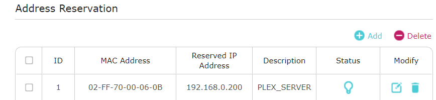

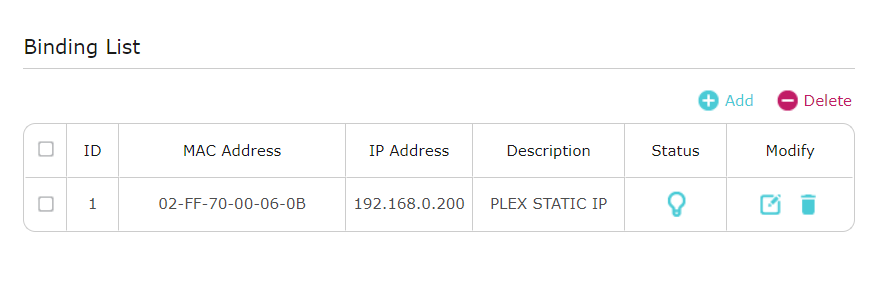

Do these steps:
1) delete the new PMS jail you created as that one doesn't have your data anyway and you said you don't know how to move your data over to the new one. so let's just fix the old one
2) go into the old PMS jail settings and and manually enter an IP address after unchecking DHCP. Make sure all the other appropriate settings are set such as IPv4 default gateway (the IP address of your router) and IPv4 net mask (which is most likely 255.255.255.0, but check your router's settings and it should tell you)
3) note the Mac address of the jail (scroll down)
4) go to your TP link router, delete all settings that are related to the new PMS jail and even the old one (including virtual servers [port forwards] and any static address reservations if you had them)
5) make sure you click the "advanced" tab at the top of the router settings window

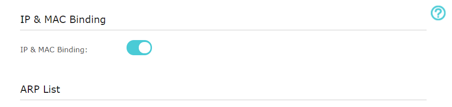

6) click on "security" then "IP and MAC Binding"
7) make sure "ARP binding" is on
8) scroll down and add a new entry under "binding list". enter the Mac address of the jail and the static IP address of the jail you picked earlier, give it a description name of whatever you want.
9) go to "network" tab on left side, click on "DHCP server"
10) under address reservation, add an entry and enter the same details (jail IP address, jail MAC address, and a description)
11) go to "NAT Forwarding" tab on left side and click on "virtual servers"
12) under virtual servers add a new entry and set "service type" to plex (enter manually), "external port" to 32400, "internal IP" to the static IP of your jail, then "internal port" to 32400, and "protocol" to "All"

When I check the router I don't see the Plex server connected in the DHCP list

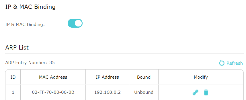

I also notice this appearing in the router even though I deleted this earlier
So the same MAC address is being given 2 IP addresses? A static one and another one ? Could that have any bearing on this ?
Many thanks

Yes that means it was assigned the 192.169.0.2 instead of the static IP you set. Which makes sense as when you rebooted DHCP was selected.

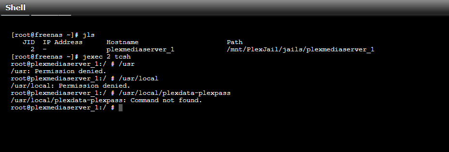

Thank you so much for replying. I also have a plex pass. Having said that, ran into a snag - I went to FreeNas and after a bit of trial and error managed to switch on "SSH" under services. Then after a bit of trial and error managed to find the "SHELL" function and go to root@plexmediaserver_1. But now can't seem to get to the folder you're mentioning. Obviously I'm doing something wrong but not sure what
Appreciate the help very much
Of note: My plex data is on a SSD in the server. Back then 2 years ago I was told it'd be a good idea to put the Plex data including posters on an SSD which I guess was true. On my network, however, I do NOT see the SSD as a volume I can access or browse. Not sure if this is relevant but thought I'd mention it.

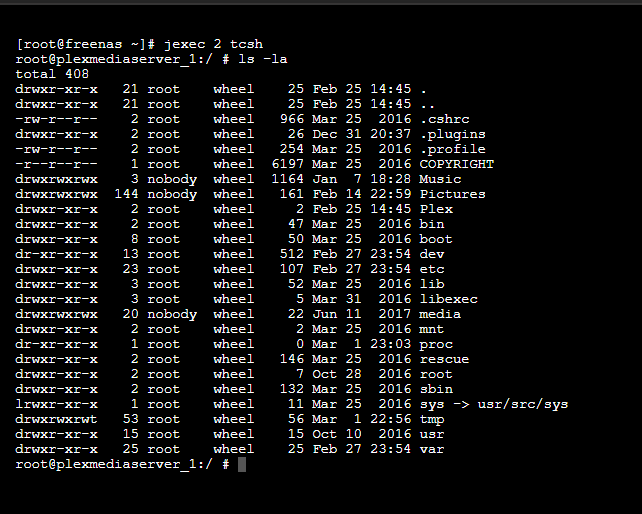

Hmm that is strange that it is telling you permission denied. You can turn off "SSH" if you don't use it. It is not required to use the shell from the GUI.
can you do an "ls -la" right after you execute the command "jexec 2 tcsh"?
nojohnny101
Dec 3, 2015
1,477
You need to type "cd usr" then do "ls -la" to see what files are in the directory.
The cd command navigates you into the directory specified, so "cd usr" puts you into the usr folder. then when you "ls -la" again you list the files and directories with their assigned permissions of the directory you are in (in this case, usr, because you just navigated there).
Does that make sense? so go through each level of that path and then you'll get to it.
