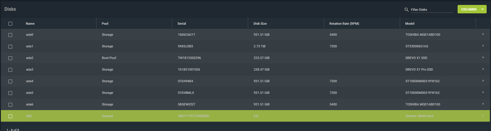

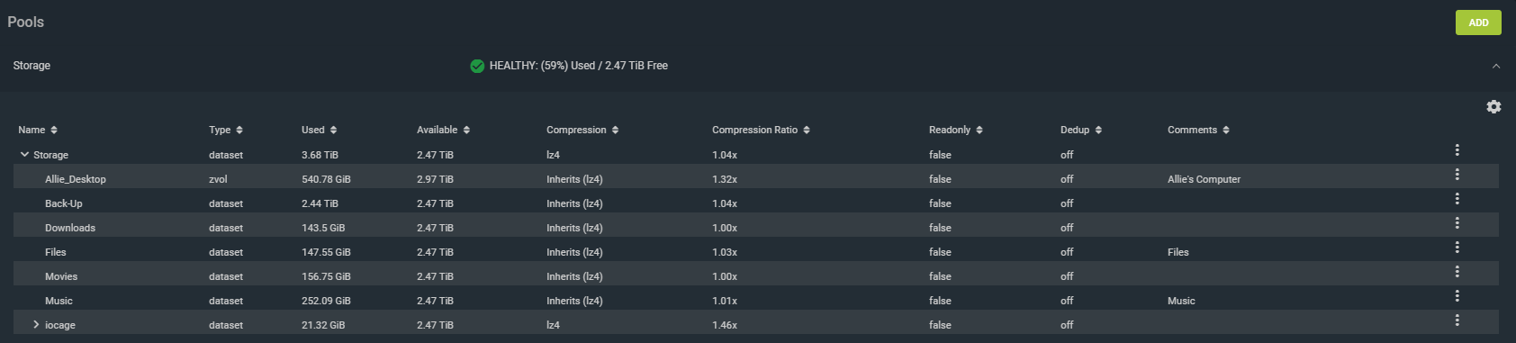

I have a possible drive change coming due to a possible failure (different post...) and I am trying to take this time to correct *any* issues I may have with my admittedly hurried first-ever FreeNAS build. I've attached some screenshots.
One of the questions I have is, If I replace ADA5, what size drive would be "best" - what if I replaced it with a 4TB vs a 2 or 3 TB or even with an 8TB etc
Another is - am I "Wrong" for mixing and matching brands / sizes etc
ADA0 and ADA6 are 2.5-inch drives installed on PCI > SSD/2.5 HDD adapters- thoughts? should they be a separate pool of their own?
Please point out anything that *should be* done differently / best practices etc

For the replacement of the drive, the size does not matter as long as it is equal or bigger to the replaced drive.
So then which drive you choose is depending on what you want to do... If you plan to expand your volume, then I would advise to go for a bigger one, with a 8TB drive you have a nice capacity/price ratio and then slowly exchange each drive until all are changed and you can expand your volume.
Mixing brand is not wrong. But mixing size... in a pool all drives should have the same size (unless you plan to expand that pool and exchange the drives one by one as said earlier).
When choosing a drive, just be careful to stay away from the SMR drives (that is independently of the brand).
From your screenshot I have the impression that you are mixing drive capacity in your pool: 4x 1TB together with 1x 3TB and 1x 256GB if I see right.
That means you probably don't have any redundancy in your pool and that is rather bad because if any drive fails, you'll loose all your pool. I hope you're aware of that...
Correct. This is just a striped pool with no redundancy. The 256GB is actually a cache. (SSD)

To get one thing clear: once you created a pool you can not change it (so you can't add redundancy or change a stripe to a RAIDz2 for example).
So you have to evaluate your needs, anticipate on the growth of your pool and decide what you want to have and also depending on your use case.
I assume this is for a home use, so nothing fancy.
Then the best thing to do is to keep it simple. :smile:
I'd go for a RAIDz2 pool, it offers good redundancy. Also a sweet spot is about 6 to 8 drives in RAIDz2, you have a nice ratio between usable capacity/space lost in redundancy.
You could go for 6x 8TB. You said your critical data is about 1TB, so you would think that you've more than enough space here, sure... but you might also consider setting snapshots and depending on the retention period, they can take some space. This capacity gives you room to plan for the future.
But sure, with 4TB drives you'll be good as well. :smile:
And your actual drives would be still useful (as long as they are not failing) for.... backups! :smile: (and this should not be underestimated)

Yes you should be able to replace your failing drive with a 4TB one.
But where I'm still not at ease here is that your pool doesn't have any redundancy. So you might first want to backup all your data and recreate a pool with redundancy.
Which would leave two bays "upgradable"
You might be able to upgrade the remaining bays with larger drives but to be able to expand the existing pool you need to change all drives from that pool with bigger ones...
Hence my previous recommendation to recreate your pool to add redundancy before otherwise you won't have any and I guess you want to avoid that.

In the screenshots you posted; ada4 is 1TB...
