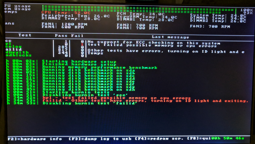

I then looked to push the system for fan speed and temperature. Within FreeNAS I copied a large number of files into the NAS, total size about 330GB. The cpu only got up to 42c. I couldn't find or understand any other tests to run within the os. Presumably, the scripts can control the fan speeds within FreeNAS but outside this would be ipmi.
Just to be clear, I had tested cpu, memory and hard drives when I first put the system together. All good.
So I went back to Breakin https://www.familybrown.org/dokuwiki/doku.php?id=fester:hvalid_cpu and ran the Standard test.

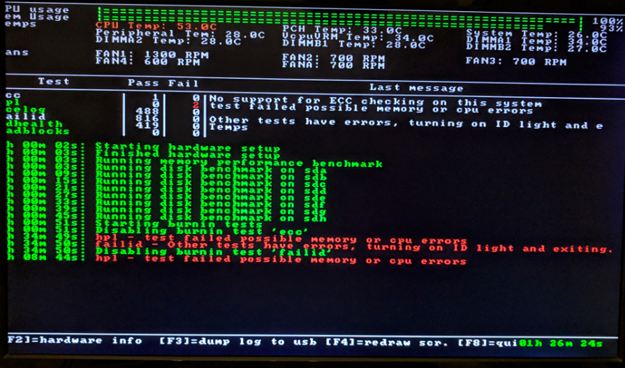

I got errors for cpu or memory file 1 below
I therefore bought and installed a brand new cpu, same spec and ran the test again. It failed, file 2

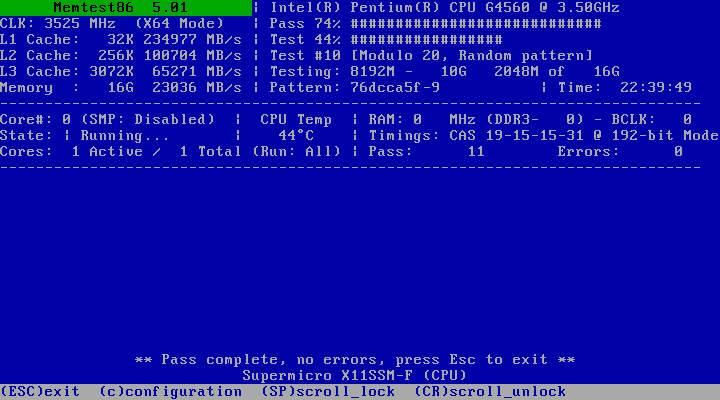

So next I ran Memtest 86+ for over 22 hours, 11 passes: no errors, file 3
I took it up with Supermicro. To me it looked like I had eliminated the memory and cpu as the cause of the errors. Surely, the mb was most likely the cause. SM either were unfamiliar with Breakin or unwilling to accept those conclusions. The rep asked my to try Prime95. I have a copy of Ultimate Boot CD which has a Mersenne Prime test. Unfortunately, my keyboard cannot navigate the menus. Legacy USB is enabled in the BIOS. I downloaded and opened the file from the Mersenne website but I don't know what to do with it!
SM also suggested AIDA64. This only supports Windows, not FreeNAS or FreeBSD.
The rep has now said he does not believe there is a hardware fault with the motherboard, file 4
Have I missed something or should I now go for RMA?
Thanks

If I understand correctly, you have successfully got the script controlling the fans, but now have what looks to you like a motherboard issue. If that is the case, it would be best to start a new thread to discuss that issue. This will avoid off-topic discussion in this thread, and it may lead to some experts reading the thread who wouldn't read a thread about PID fan control scripts.
As far as your apparent motherboard issue, I am not sure where you should go from here. Hopefully some more knowledge folks can provide useful advice.
