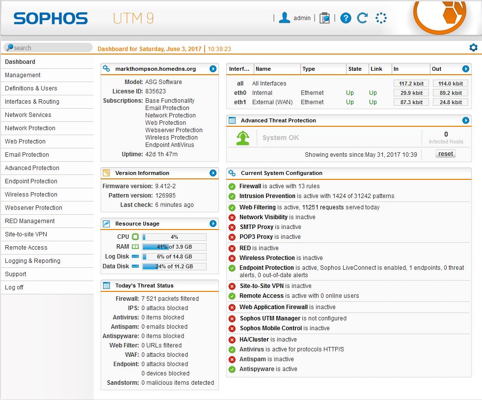

Roughly, how many hours/days of hands-on time to dial in SOPHOS UTM? Any downsides you have seen vis-a-vis PFSense?
Also see you are running it on VM. Any additional complications as aganist running on dedicated hardware?
It took a lot of research to get it up an running with all the protection I want, the firewall is not very forgiving either. I'd say you are talking about maybe a few hours to get it setup the first time to be operational with some traffic filtering. PFSense would take about the same amount of time. Keep in mind that this is just a basic setup, not all the protection features. Added features will take longer to understand and then setup. I have very little time running PFSense so I can't speak to some of the add-on packages that you would need to install to make fairly equal systems.
I run Sophos on a VM becasue the AMD hardware would not run Sophos on bare metal. ESXi allowed me to use old hardware. When it comes to using ESXi there are bound to be complications, one such complication is updating ESXi itself. I prefer to download the files and do the update online and I can do that for my main system however for the ESXi for the Sophos, well you need to stop the VM to do the upgrade and then I have no internet. There is a way to download the updates first if I wanted to but I just temporarily connect my backup router and perform the upgrade over the internet. Its quick and painless but it does leave my system vulnerable for the 10 minutes I'm using the backup router. And I would not recommend ESXi or any other VM platform for running primary applications like this unless the user fully understood what the limitations were. I originaly ran the firewall also off of my main ESXi machine but if I entered maintenece mode, then the entire house lost internet and I had a wife, daughter, and father all telling me the internet is down.
So, if I could run Sophos of dedicated hardware that I presently have, I would.
To summarize... I think more people on this forum use PFSense so you might find more setup help here. The Sophos forum is very helpful and they have always come through for me but they are not always speedy in providing an answer, it could take a few hours. Both are good products and both have similar hardware requirements in order to provide the same type of protection. Sophos has a license which expires but it's a free renewal for home users. I think of this as good marketing strategy, get the IT guys to use it at home and they may get the work place to purchase it. Either product will require some work on how to setup the product, Sophos is not the easiest and I can't speak for PFSense yet, just not enough time using it yet.
My recomendation is to try PFSense first and if you want to try Sophos UTM, give that one a shot.

I finally read something that I can agree with you about, Sophos UTM9, baremetal.
I find Sophos menu system to be easy to use. Power does introduce some complexity. One does need to think and learn.
garym
Jul 24, 2012
37
Roughly, how many hours/days of hands-on time to dial in SOPHOS UTM? Any additional complications as aganist running on dedicated hardware?
Depends on you and how many features you need to turn on. Do you need hand holding or are you a self starter? Once UTM9 is setup it runs on it's own. Then the odd update that only takes a few minutes.
Best on dedicated hardware, and that is based on usage requirements.
