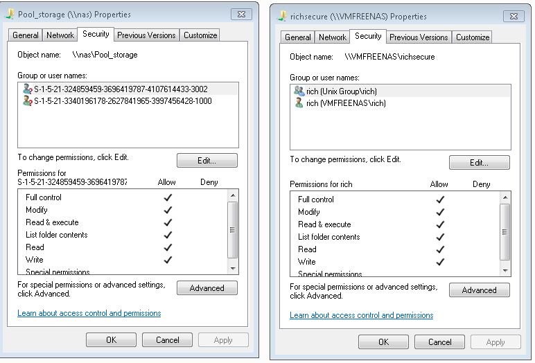

RichTJ99
Sep 12, 2013
384
I dont have any help but think i am in the same situation. The "everyone" group is added to each shared CIFS & if I delete it it comes back later, again exposing all data. My usernames in the windows share show up as a numerical combination but on a test VM it seems to work fine.
I was never on 9.2 only 9.3. I did a freenas reinstall (left the pool alone) and am having issues.
The plus side for me is that i have only 2 users, and 2 groups.
I have two pools and am tempted to:
Copy the data from my main pool to my backup pool, destroy the main pool, recreate the pool & start from scratch, then copy files from the backup pool onto the main pool.
I also was using unix shares because it was the default & it just worked.

I have finally fixed the remainder of my issues. It seems that two users insisted on using SIDs from some other installation. I would go to add the user's new SID and then it would combine them under the old SID for some reason and deny access. Went ahead and deleted the account, recreated it with the same account name, but different User ID number and all is well. All my groups show up, as well as, my users.
As for Rich's question, make sure that all of your shares are set to Windows. Or "restricted" as was discussed earlier in this thread. That was the first step to getting the permissions to behaving in a predictable way. Then reset default permissions via the GUI in share settings or via the CLI using winacl. After that, when you delete Everyone, it will stay that way.
The order that worked for me.
1. Make sure all shares are set to Windows type.
2. Reset default permissions using checkbox in GUI.
3. Uncheck and begin setting up your own permissions via a Windows machine accessing the share as root user.
