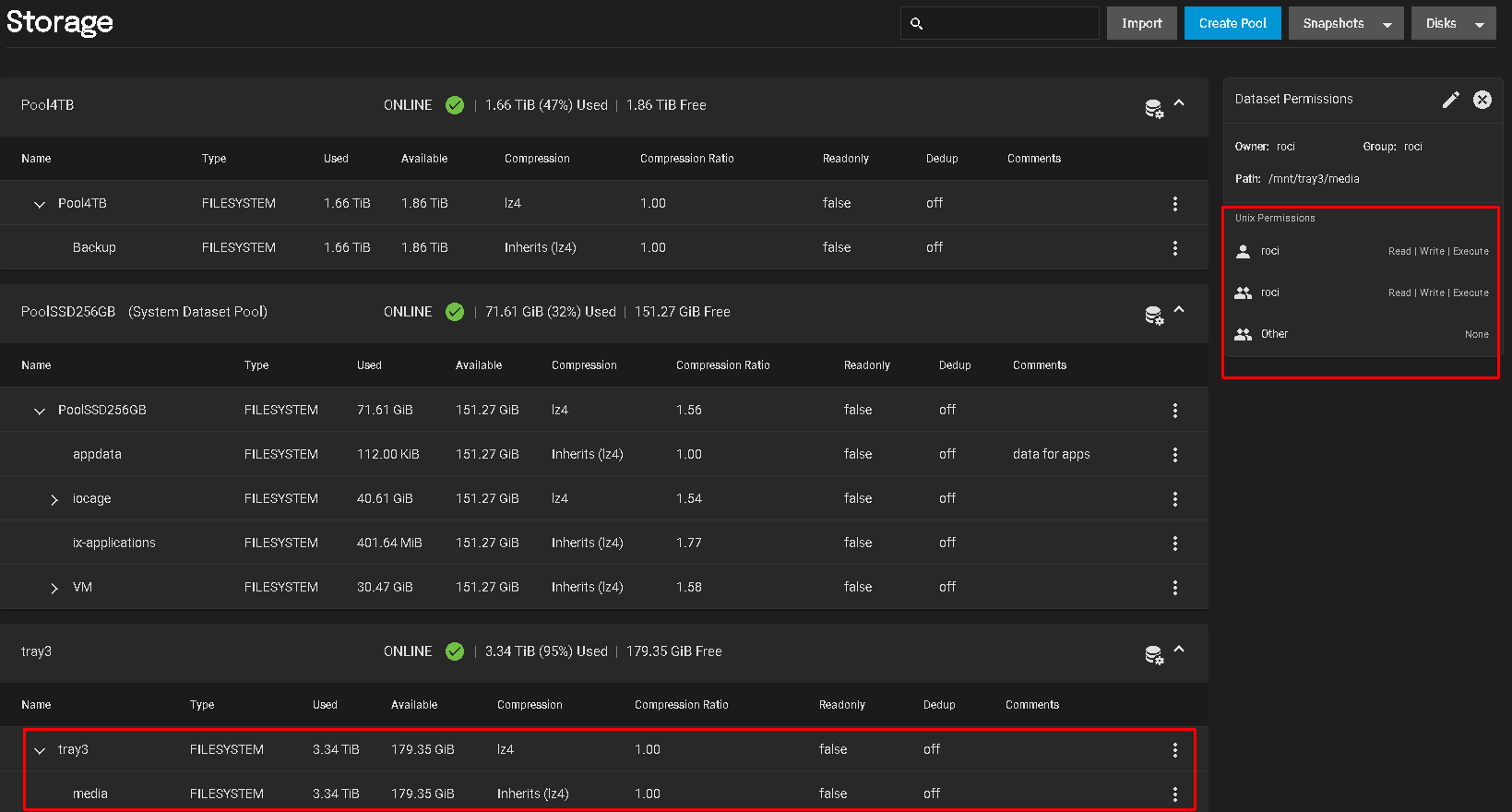

Hi TrueNAS community,
maybe somebody can help with my problem...
I have a HP Microserver Gen8 which I just upgraded from "TrueNAS CORE 12.0-U5.1" to "TrueNAS-SCALE-21.08-BETA.1".
Upgrade did not work, got some error messages (maybe because I changed booting from "with USB chainloader" to "Raid boot").
But this is another story...
So in the end I did a fresh install.

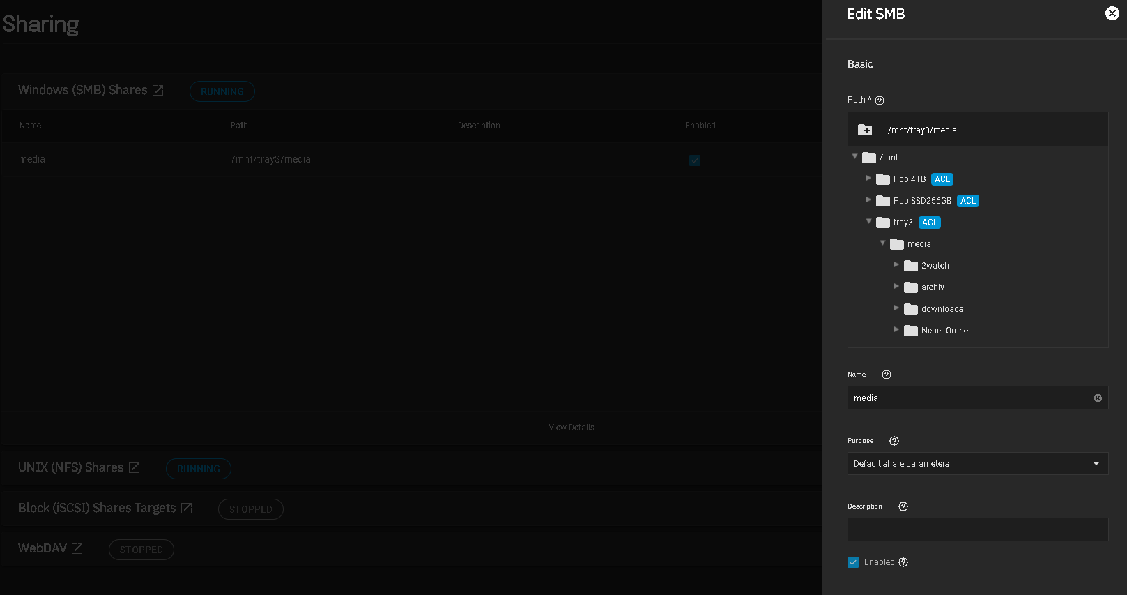

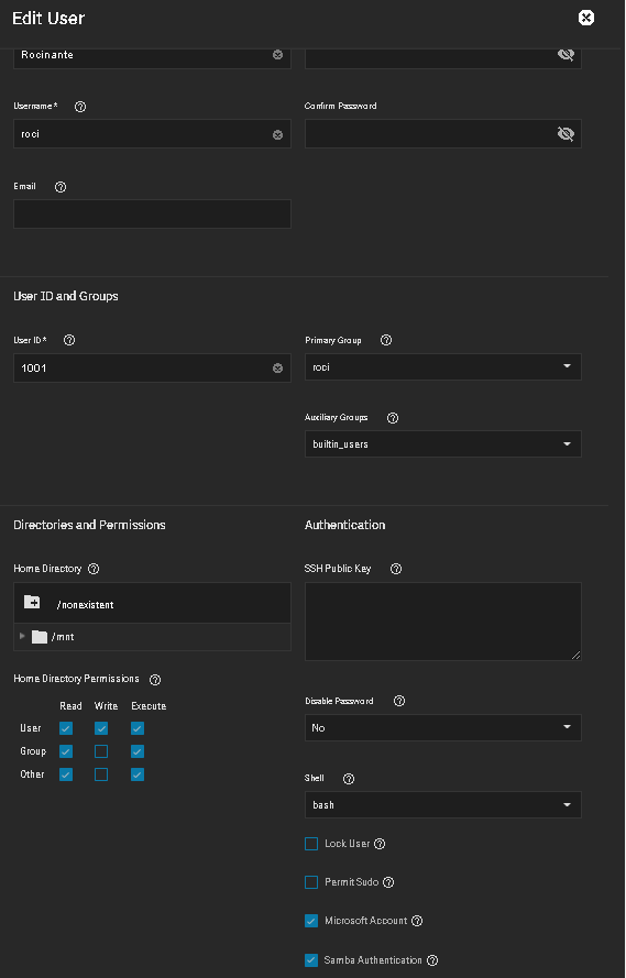

Now I did an import from my data pools, created a new user and share, assigned the user permissions to the share...
Under Windows I can connect to the share with the user, and I can create folders....
But I can not access the existing folders within the share.
My username is roci
root@truenas:/# ls -lrta /mnt
total 19
drwxr-xr-x 20 root root 30 Aug 31 01:23 ..
drwxr-xr-x  3 root root  3 Sep 13 14:05 Pool4TB
drwxr-xr-x  5 root root  5 Sep 13 14:06 .
drwxr-xr-x  6 root root  6 Sep 13 14:07 PoolSSD256GB
drwxr-xr-x  3 root roci  3 Sep 14 11:15 tray3
root@truenas:/# ls -lrta /mnt/tray3/
total 10
drwxr-xr-x 5 root root 5 Sep 13 14:06 ..
drwxrwx--- 6 roci roci 6 Sep 14 10:40 media
drwxr-xr-x 3 root roci 3 Sep 14 11:15 .
root@truenas:/# ls -lrta /mnt/tray3/media/
total 27
d---------  3 roci roci  3 May  2 13:56  archiv
d--------- 10 roci roci 12 Sep  2 18:08  downloads
d---------  8 roci roci  8 Sep 13 19:11  2watch
drwxrwxrwx  2 roci roci  2 Sep 14 10:40 'Neuer Ordner'
drwxrwx---  6 roci roci  6 Sep 14 10:40  .
drwxr-xr-x  3 root roci  3 Sep 14 11:15  ..
I think it is related to acl reset permissions, but I could not figure it out.
thx for an help!
