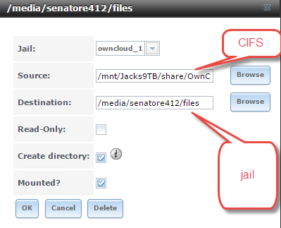

Here is how its setup now. I prob do have something wrong but I know it used to work just fine. I attached a screen shot
yeah, that's wrong.you should be mounting that somewhere else like /mnt/files2. then in owncloud install the external mountpoint app, and mount it to your users folder through the admin > mount page
