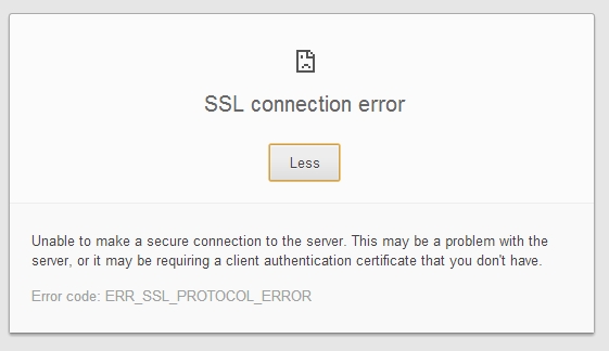

Hi cyberjock. This is the message Google Chrome gives me when I switch from http to https. SSL certificate required maybe?

Hmm.. I'm wondering if Chrome doesn't like the self signed cert...
cyberjock
Inactive Account
Mar 25, 2012
19,526
I just installed Chrome on my laptop and when I go to my owncloud page it says:
The site's security certificate is not trusted!
You attempted to reach 192.168.2.121, but the server presented a certificate issued by an entity that is not trusted by your computer's operating system. This may mean that the server has generated its own security credentials, which Chrome cannot rely on for identity information, or an attacker may be trying to intercept your communications.
You should not proceed, especially if you have never seen this warning before for this site.
Not sure if you've changed your browser settings to reject self-signed certs?????
