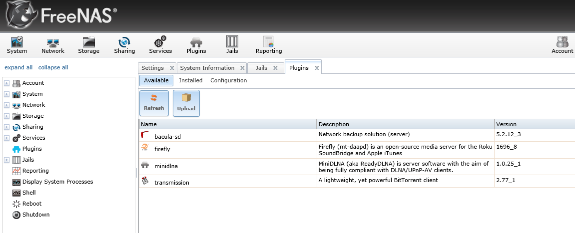

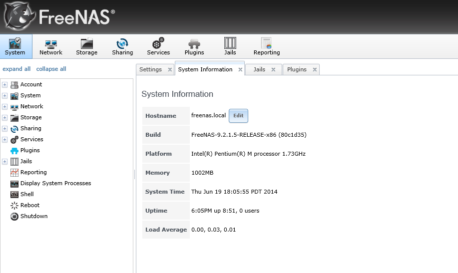

Owncloud is not in "available" tab of plugin menu(picture 1). I downloaded the owncloud dpi from http://www.freenas.org/downloads/plugins/9/x32 and installed dpi using "upload" button. Then I can see Owncloud plugin in "installed" tab of plugins(picture 2). But I cannot turn "Owncloud"on. Error message shows on the top of page as "some error occurred". Any suggestion on getting owncloud working will be appreciated.

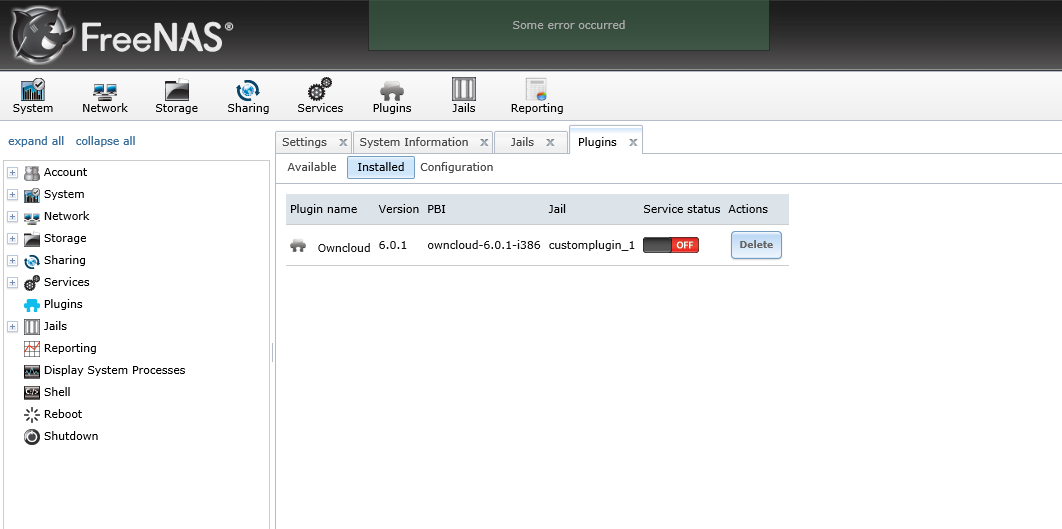

I attached the system information of NAS server (picture 3)

Ugg... you've got 1/2 the minimum RAM for UFS, 1/4 the minimum RAM for ZFS. If you don't have the minimum 2GB or 8GB as appropriate you can expect things to not work right. You also have a substantial risk of losing data. Even as an 'experimental' machine you should upgrade just so that FreeNAS behaves correctly.
That particular problem you are seeing though is because you are using the x86 version.

The OP does not have these plugins because he is running the 32-bit version.
