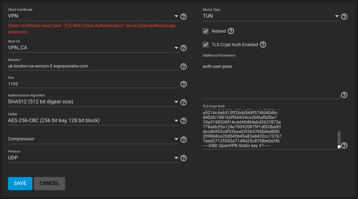

Really sorry if this has already been posted before but I can't for the life of me find an answer to my problem. The image says it all :confused:

How did you generate your certificate? If you use the TrueNAS builtin CA, most probably all necessary extended attributes will be present.

The Certificate is from the .ovpn that I downloaded from my ExpressVPN account.
I've created the CA and Certificate with all the appropriate info needed but just stuck with this error..

Are you sure that you created a USER certificate and not a SERVER certificate ?
As the error message says, the proper Key Usage is not listed in the certificate, so you got it wrong when you generated it.

Make sure you copied the client cert and not the CA cert - all-in-one .ovpn files contain both. Other than that I am at a loss, sorry.

I simply followed System > Certificates > (Type > Import Certificate) then entered the rest of the details..
If there's something obvious I'm doing wrong then correct me please!
That is how you IMPORTED the certificate. Not how you GENERATED the certificate.
Once a certificate has been generated, it can not be modified. It must be revoked and a new one must be produced.
So how did you GENERATED the certificate ? What tool ? What option ? What values ? ...

As I said in previous message I just took it from the .ovpn file that I downloaded from my account at ExpressVPN, looks like this;
<cert>
-----BEGIN CERTIFICATE-----
cert code here...
-----END CERTIFICATE-----
</cert>

As an OpenVPN client, you need also the private key that goes with the cert... Did you extracted that one too ? How did you injected it ? As a separate field or did you merged the key and its certificate in a .p12 profile ?

The private key is on the certificate as well, looks like this;
<key>
-----BEGIN RSA PRIVATE KEY-----
key code here...
-----END RSA PRIVATE KEY-----
</key>

Yes, the private key is also in the file. But again, how did you GENERATED that key pair ??? Whatever you did, you got it wrong. You are missing the proper key usage in your certificate.

I don't get where you're going, I got it the exact same way I got the rest, by downloading it from my account and inserting the code...

Hmm, you said you got it from the OVPN file. That is where you got it, but not how you generated it.
Can you please focus on providing the information on how you generated the certificate so that we can help?

I didn't generate any codes, its was from the .OVPN file that I pressed download on from within my ExpressVPN account.
I don't get how that's so hard for you to understand. Either help or get lost!

So there seems to be some confusion here as to what is going on.
How about you start over from the beginning, and tell us what you are trying to do.
A careful reading of what's transpired suggests that no one is really clear on what you are trying to do.
Are you trying to set up your FreeNAS as a client of ExpressVPN? That would be highly unusual and probably a bad idea, though it seems the most likely explanation behind what you've posted.
If that is the case, it appears that the certificate that ExpressVPN has issued you is defective in that it doesn't supply a client extended key usage (EKU). Locking certificates to certain roles with EKU's is best practice.
You can decode a certificate with the openssl command:
% openssl x509 -in mycertificate.crt -noout -text
and you should find a line such as
X509v3 extensions:
X509v3 Extended Key Usage:
TLS Web Client Authentication
in there. If not, that's not particularly good, and is something that ExpressVPN would be in a position to fix. That was why Heracles kept asking you how you had generated this.
In any case, it is a bad idea to open up your NAS to the Internet. You may wish to reconsider this.

No need to get rude. What is "ExpressVPN"? How do you expect anyone but you to know what arbitrary service offers are and how they work? How does "ExpressVPN" generate the certificate? If you don't know, ask them, because they are doing it wrong. You cannot use a certificate without the Extended Key Usage attribute. Period.
The other things @jgreco wrote, apply as well ...
Well, that's not *strictly* true. It used to be that we didn't bother with these things because there were so many poorly-implemented, old, etc., versions of SSL out there that would be made unhappy by "newfangled" things. SSL has been supporting this very well for many years at this point, however, and any VPN service that isn't bothering with it ... well, it can be assumed that they do not give a crap about security, or are simply incompetent.
Part of the point of EKU is to prevent man-in-the-middle attacks.
If I want to compromise your VPN, and I can get in your transit path, then all I need to do is to sign up as an IncompetentVPN customer, and I get a certificate that isn't restricted to being a client. I then use my certificate to pretend to be a server facing you, crack open the SSL, and then use the same certificate as a client certificate into the IncompetentVPN service to relay the traffic. This is a very low cost attack.
All because someone was too lazy or incompetent to add a few bytes to a certificate.
Anyways, if this is the case, it is possible to tell OpenVPN to ignore EKU, but that's a really bad idea, and it isn't clear to me where the message quoted in the first post is originating. I suspect it is a FreeNAS middleware sanity check of the certificate, and because this is not only a best practice but also an important factor in SSL security, I wouldn't hold high hopes of the developers removing the check, and even if they did, OpenVPN would still need to be tweaked.
It would be better to prevail upon the VPN provider to secure their stuff properly, or find a better vendor.
And it's still a bad idea to expose your NAS to the Internet, so maybe you should be thanking them instead.
