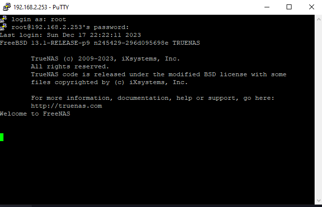

i have a problem with my TrueNAS-13.0-U6.1 running on HP microserver 5.gen (AMD Turion(tm) II Neo N40L Dual-Core Processor, 16GB RAM) . For two years the server was running without any problem and now for the last month it has been behaving erratically.
When I enter its WEB UI in the browser, it is unavailable, but the server responds to ping, all services such as PLEX, qBittorrent are running, but samba sometimes works and crashes after about 20 hours of UI unavailability. I have SSH enabled as a service, and since I don't have the UI available, SSH is not available either. And when SSH is available, it does not start correctly, see screenshot.
Restarting the server will help, but the UI is available sometimes for 5 minutes and sometimes for 3 days.
I'm getting desperate now. I currently have no possibility to connect any console to the server, so I solve it by restarting, which is very bad.
Thanks for the advice.

Hello,
so updating my problem.
As I looked in the logs and in general, all the problems were caused by the non-updated PLEX server. CPU usage decreased after updating it.
WEB UI, SMB and SSH work all the time without any problems.
Thank you all for the advice, but as I suspected, the problem was in the SW.
