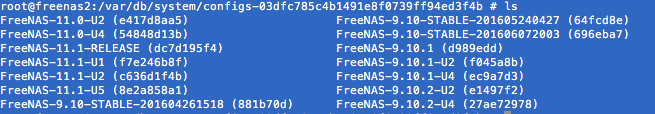

They shouldn't have been:

Interesting, mine doesn't have the old config files in that directory; I'll see if I can grab a screenshot / list from there later to share. I'll also check my other VM to see if that one has any previous ones too.
cancel my last; the previous configs are in that folder! My bad!
I'm guessing the daily config backup overwrites the previous one when it backs up at 0345, seeing as both you and I only have one version of each?
15,456
No, each of those is a directory, and contains the backup from each day it's been run.
