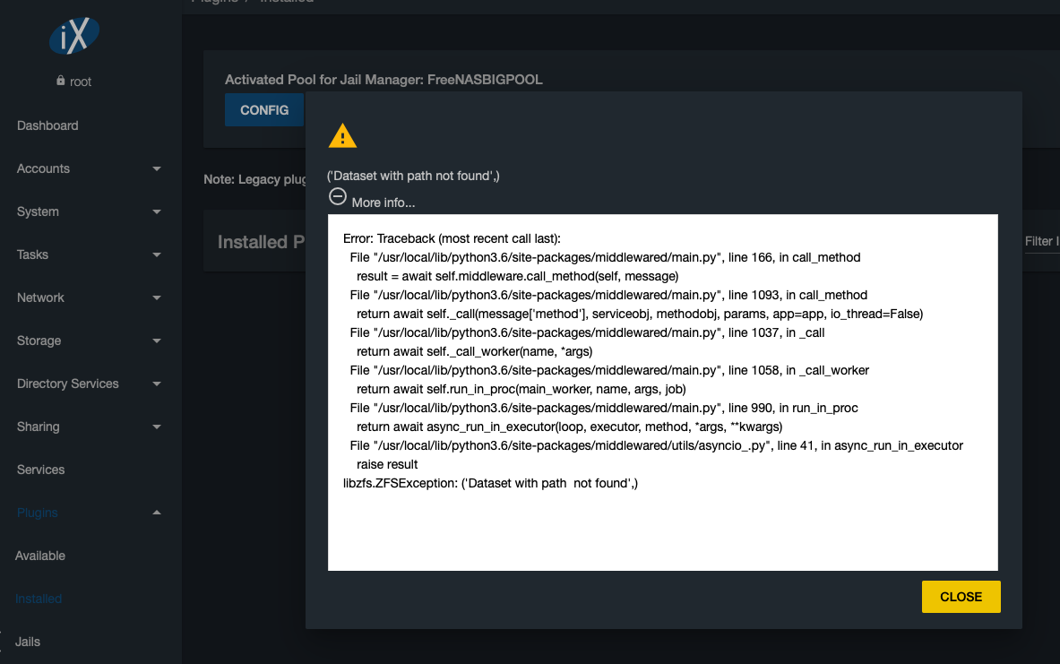

I'm having this exact issue after having to roll back to 11.2 (booting from USB was causing me issues, oddly, with 11.3). I don't have any jails with spaces or periods. Anything else involved in the solve here?
okynnor
Mar 14, 2019
71
I'm having the exact same issue where I upgraded to 11.3U1. When the FTP feature didn't work, I rolled back to 11.2U8. The Jails are not installing now. I get "('Dataset with path not found',)" but the pool is configured and activated for Jails. Another bugs? have to wait?
File "/usr/local/lib/python3.6/site-packages/middlewared/main.py", line 166, in call_method
result = await self.middleware.call_method(self, message)
File "/usr/local/lib/python3.6/site-packages/middlewared/main.py", line 1093, in call_method
return await self._call(message['method'], serviceobj, methodobj, params, app=app, io_thread=False)
File "/usr/local/lib/python3.6/site-packages/middlewared/main.py", line 1037, in _call
return await self._call_worker(name, *args)
File "/usr/local/lib/python3.6/site-packages/middlewared/main.py", line 1058, in _call_worker
return await self.run_in_proc(main_worker, name, args, job)
File "/usr/local/lib/python3.6/site-packages/middlewared/main.py", line 990, in run_in_proc
return await async_run_in_executor(loop, executor, method, *args, **kwargs)
File "/usr/local/lib/python3.6/site-packages/middlewared/utils/asyncio_.py", line 41, in async_run_in_executor
raise result
libzfs.ZFSException: ('Dataset with path not found',)
