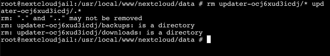

Well, thanks! I tried removing it, but I'm not an expert with it. How do I remove it? I tried 'rm' 'rmdir' and some other. Also tried te command below. Can you help me with removing it?

how about rm -r updater-xxxxxxx ? I have the feeling that you are over-complicating things for yourself. FreeBSD CLI commands are pretty straight forward

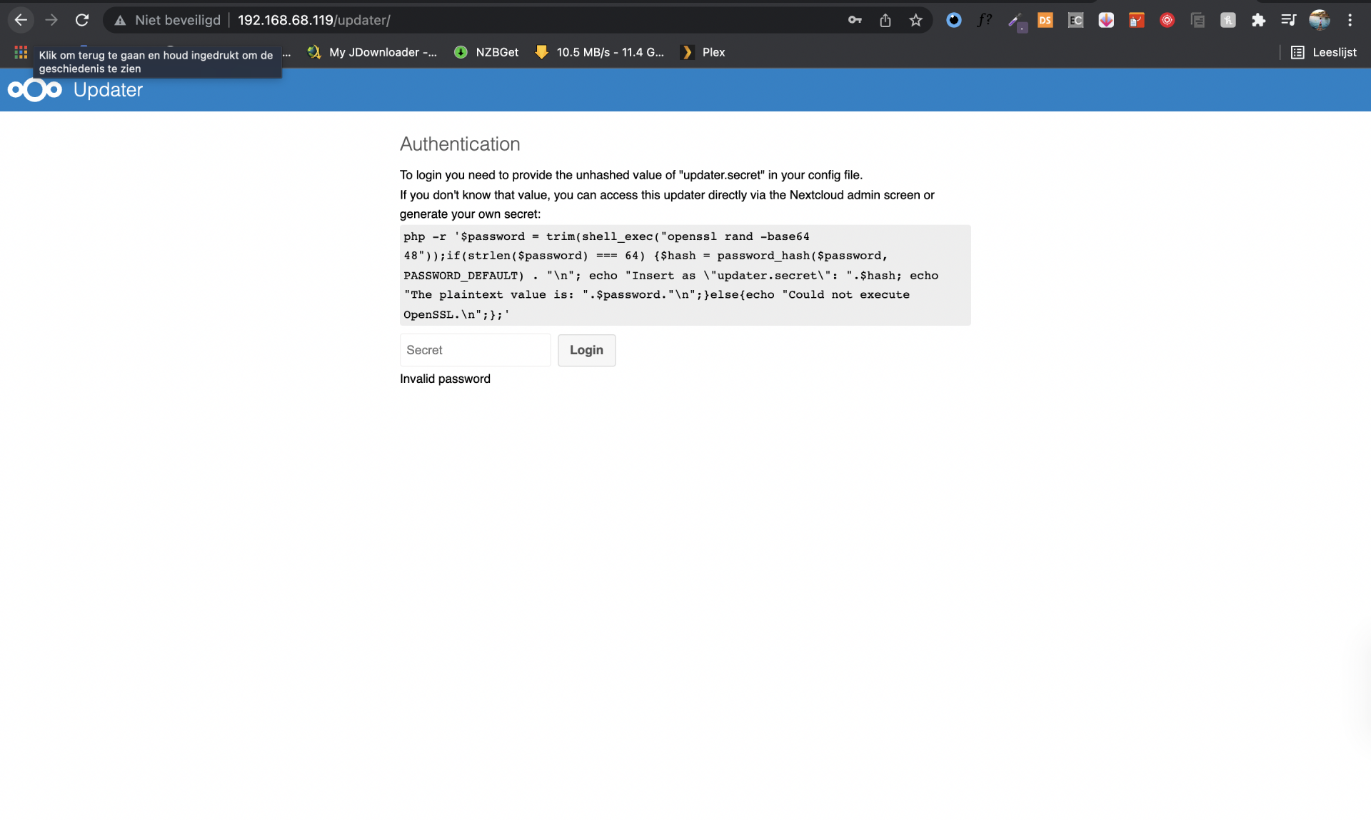

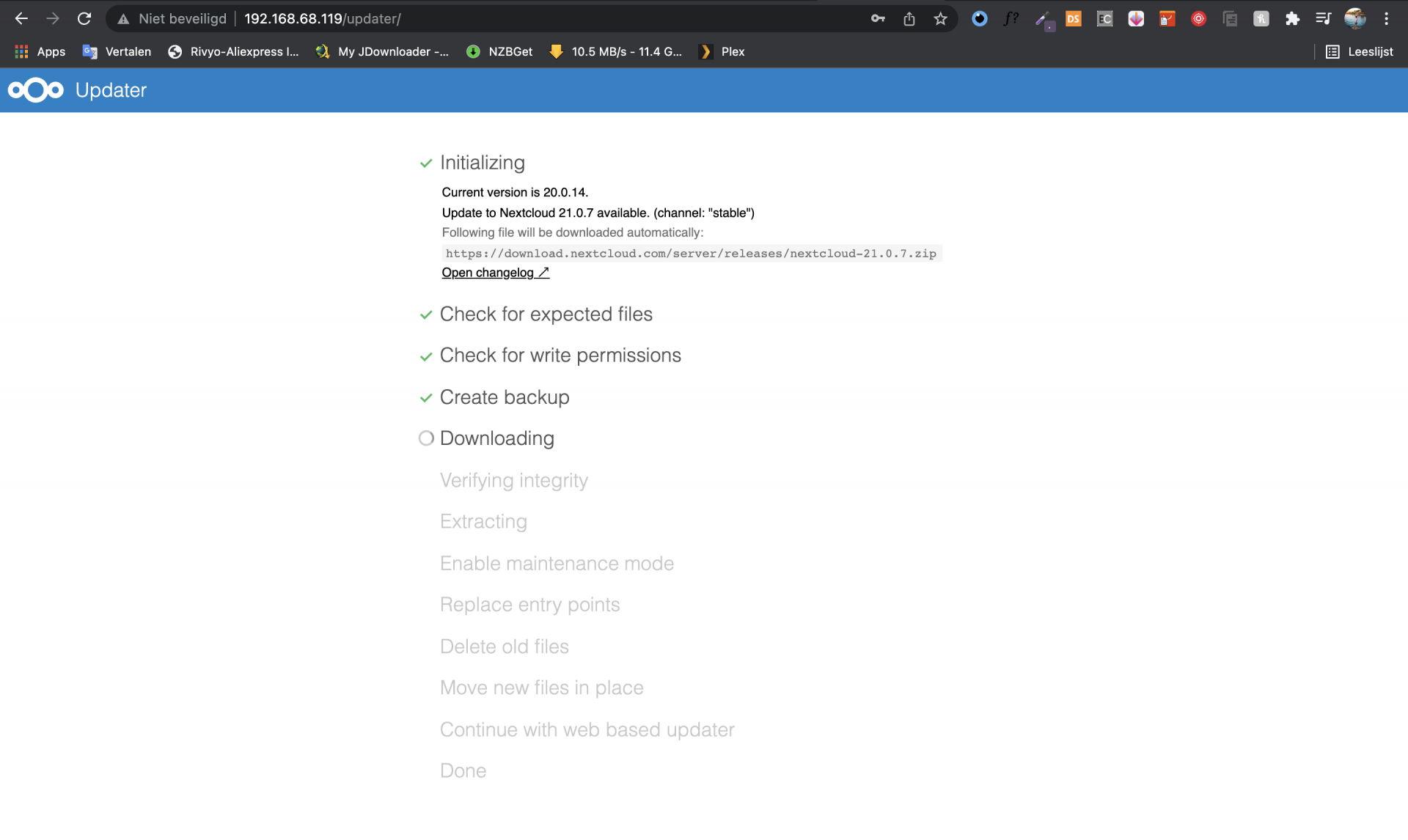

Well, I did delete the directory, and if I go to the domain, I still get update in process.

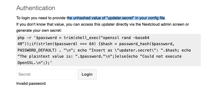

On the good side, if I go to /updater/ I get
When I go to config.php and copy the updater.secret it does not work. How do I unhash it? Or can I do it on another way...?
@ddaenen1
Dec 7, 2021
8

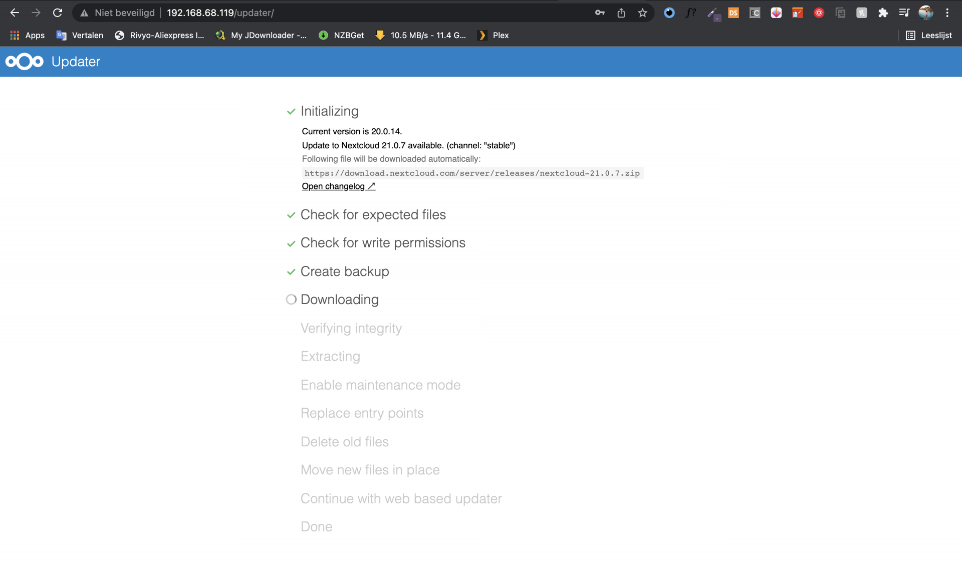

Well, alright, I scrambled back my old PHP skills, and he is currently doing the update again, figured out how to get the play text.

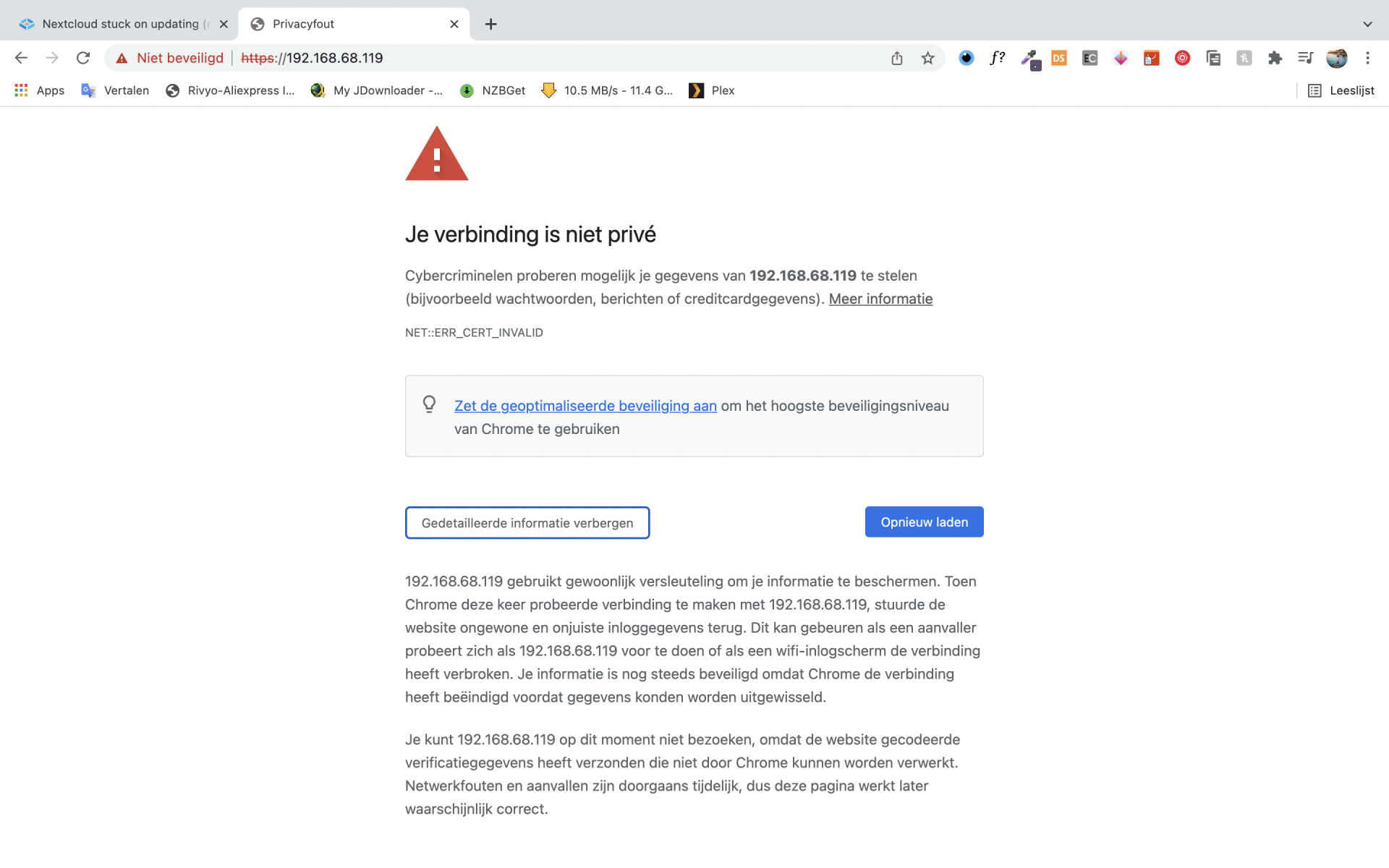

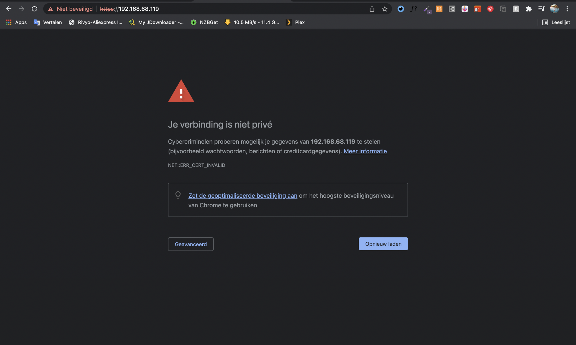

Alright, did not know that was possible, but thanks! But I think I made a new mistake here. It kept failing in the GUI, so I started the update in truenas... I don't know what happend but I was logged out of my server and now if I start nextcloud, it wont work... I get some sort of error message from Chrome... It is in dutch, but it saids that my connection isnt private, and after some restarts I cant get it to work... How to fix it?

Honestly, i am not sure that was a smart move. I did my updates via the GUI first but it got me into big trouble when i tried to update it afterwards through TrueNAS. It resulted in doing a complete new install from scratch. Does Chrome allow you to accept the "unsafe" cert?
