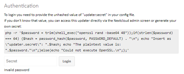

And every time I open the webpage for updater (mydomain.com/updater/), I am presented with the following text
However whenever I copy the secret from config file or try to generate it using the given command, I am presented with Invalid password text as seen above.

If you already have a snapshot schedule, you should be able to rollback that jail. If not, and you prefer to continue to update manually, taking manual snapshots in the future before updating is a good thing :smile:
If a snapshot isn't available for the failed update, you could still try a few things. One is to do a fresh installation using Plugins to see if that works out for you (or if you like that method). Alternately, you could create a new jail and try a manual fresh install in there.
mkiisk
May 1, 2019
4
If you already have a snapshot schedule, you should be able to rollback that jail. If not, and you prefer to continue to update manually, taking manual snapshots in the future before updating is a good thing :)
Ah this is really helpful - I will definitely keep to snapshots for anything manual I do in the future.
Also - I did the upgrade using the link you provided. This then seems to then have fixed my original install. Even though I was unable to get out of maintenance mode for Nextcloud, I then ran the updater again on the jail and this successfully updated Nextcloud to version 16.
I did have to then manually take Nextcloud out of maintenance mode and it appears I needed to redo the Cloudflare certifications for my nextcloud install as they were completely missing, but it's all back up now!
