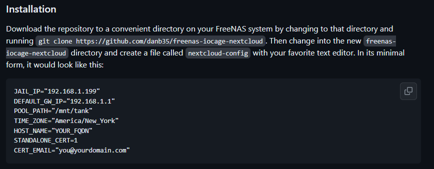

Hey guys,
I apologize for the stupid question.
I'm trying to follow the instructions from danb35, but I actually have no idea how to achieve the below:
Installation​
Download the repository to a convenient directory on your FreeNAS system by changing to that directory and running git clone https://github.com/danb35/freenas-iocage-nextcloud. Then change into the new freenas-iocage-nextcloud directory and create a file called nextcloud-config with your favorite text editor. In its minimal form, it would look like this:
JAIL_IP="192.168.1.199"
DEFAULT_GW_IP="192.168.1.1"
POOL_PATH="/mnt/tank"
TIME_ZONE="America/New_York"
HOST_NAME="YOUR_FQDN"
STANDALONE_CERT=1
CERT_EMAIL="you@yourdomain.com"
I'm not sure how to download to a convenient directory let alone the rest of that sentence.
I'm unfortunately pretty new to this but eager to learn.
I'd appreciate any info.
Thanks.

In the TrueNAS shell, go to a directory that you want, cd /usr/local is what I alway do, the do git clone https://github.com/danb35/freenas-iocage-nextcloud the to enter that directory cd freenas-iocage-nextcloud and to create the config file inside that directory do edit nextcloud-config and fill in the config file with your IP and the rest. Then hit ESC and make sure to save the file, then do script nextcloud.log ./nextcloud-jail.sh to run the script.

Since your new it also bears mentioning that you should be doing this all via SSH and not the shell in the webUI.

Please note the below config I'm currently running:
JAIL_IP="192.168.X.XXX/24"
DEFAULT_GW_IP="192.168.X.XXX"
POOL_PATH="/mnt/MeinallNAS/nextcloud"
TIME_ZONE="Australia/Perth"
HOST_NAME="soanderou.com"
NO_CERT=1
CERT_EMAIL="XXXXXXXX@gmail.com"
I'm currently hosting through google and I think this might be why it isn't working?

This sounds like you might not have properly configured your gateway and such.
Can you confirm your default gateway and dns server on your truenas host is set?
Sorry mate, pretty new to this.
What's the best way to confirm these?

Network > Global Configuration - Nameserver 1 and IPv4 Default Gateway fields must have proper values.

Thanks Patrick,
I can confirm they're all blank.
I've created a nameserver on my google domain. Waiting for it to propagate, then I'll insert the details and try again.
Hoping this is what I'm supposed to do?
