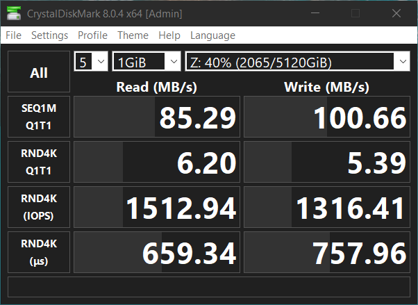

First on iSCSI (Z drive). I have CDM Profile set to "Real World Performance" and "Read+Write[+Mix]":

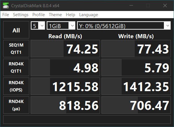

Second on the Samba network share (Y:). Again, I have CDM Profile set to "Real World Performance" and "Read+Write[+Mix]":
Not sure if the settings for CrystalDiskMark were the optimal way to test this, so please correct me if I did them wrong. But that is what they show.

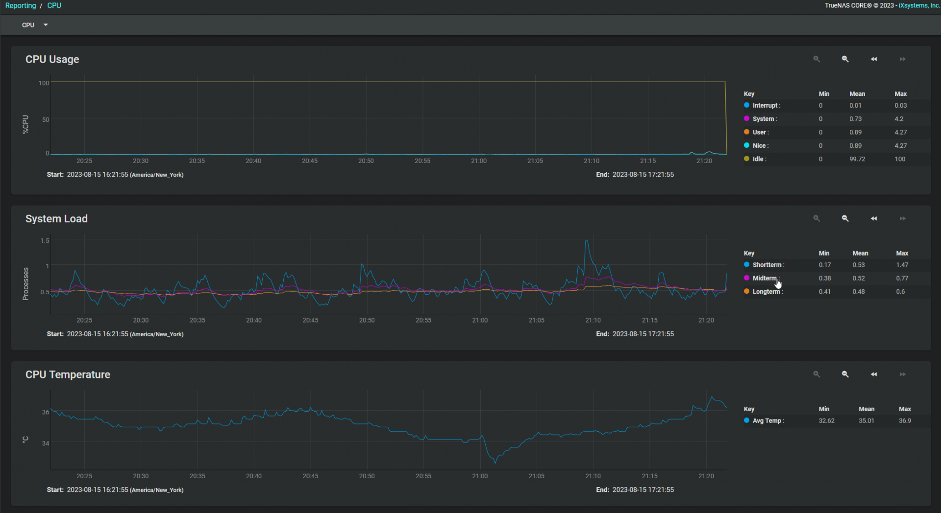

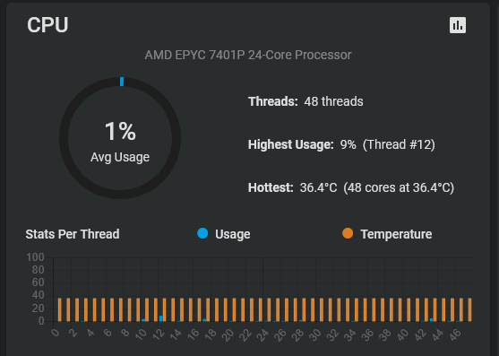

I notice that my CPU usage according to TrueNAS on the main dashboard (first pic) is only hitting about 2-4% max and it drops back to 0. So it goes like 0% to 1% to 0% to 2% to 0% to 1% to 0% to 4%. Not sure if that is weird?

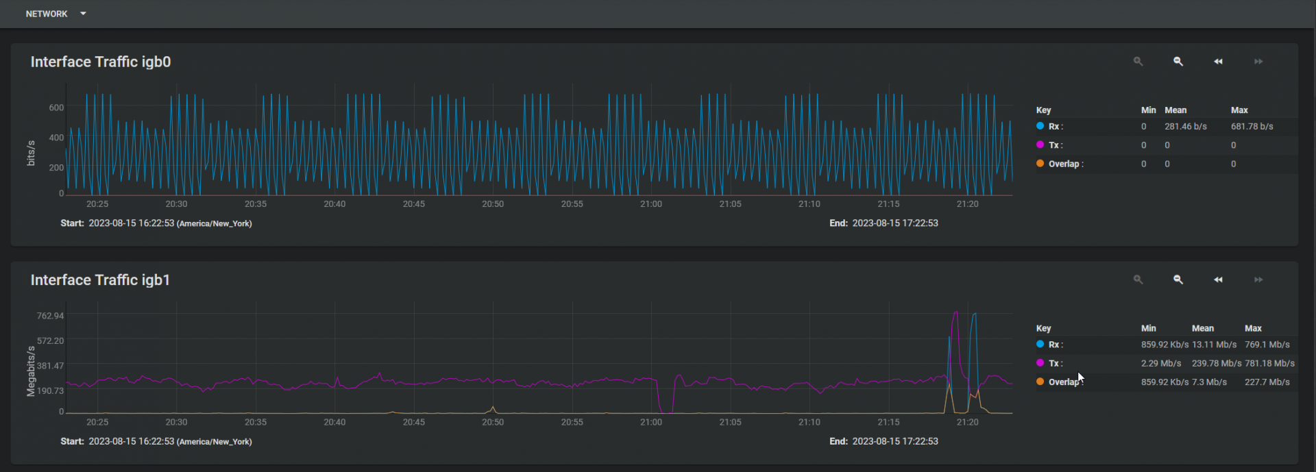

and here is more detailed CPU and Network graphs from TrueNAS reporting if it is of interest.
Btw igb0 is not even an active link, it's down.. so not sure why it even shows anything there on the graph. I see it's in b/s though so idk not concerned.
But just wanted to make that clear. igb1 is the only active link.

Are the results from CrystalDisk, a bit mediocre?
Only 6 MB/s random..?
I guess the sequential are pretty close to what you suggested though. 100MB/s comes out around 800mbps right. And the network graph shows a max of around 780mbps for RX and TX.. So I guess I am bottlenecked at my networking.
But the random speeds don't make sense to me? That is super low.
Also is that low CPU usage normal? I know the CPU is a bit overkill, but not much more than 4%? lol
Right now it's resilvering and I'm playing a movie from it (Jellyfin on my desktop, but the media file on the NAS) and it is showing "Highest Usage: 1% (3 threads at 1%)". Like that is insanely low it seems. Not complaining, but just wanting to make sure it's not constricted or something.
