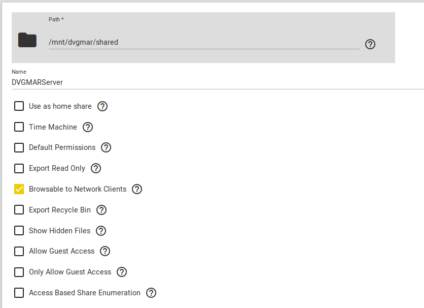

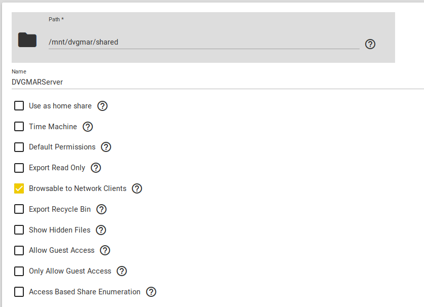

diedrichg
Dec 4, 2012
1,319
The only checkbox I have in my SMB share is
My permissions:
dvgmar (pool name) - root/wheel, 777, no recursive permissions
.....shared (dataset) - root/family, no recursive permissions [I just noticed that this was a Windows ACL, I thought all my datasets were Unix]
..........media (dataset) - root/family, 775 [this should be 770 but apparantly I have a folder in there that won't change permissions]

Monkey_Demon
Nov 11, 2016
85
My permissions:
For the Users SMB share:
  • Browsable to Network Clients is checked;
  • Because Users' is where users' home directories are, the "Use as home share box is checked";
  • Because users need to modify configuration files, the "Show Hidden Files" box is checked.

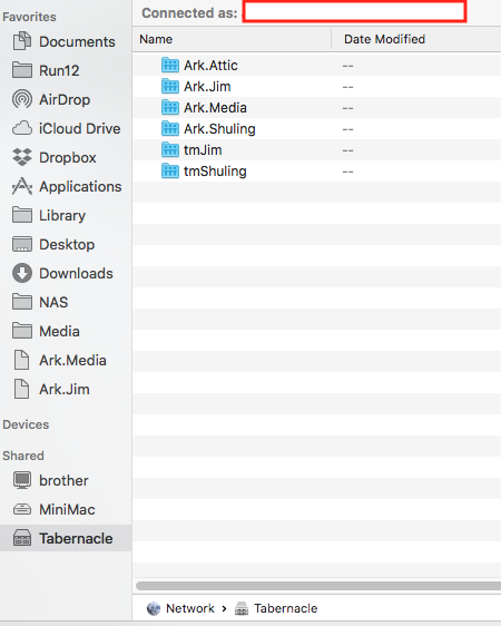

Glorious1
Nov 23, 2014
1,211
I'm still using only AFP. People have been saying for over six years that Apple is dropping it - if and when they do I'll cross that bridge. My Mac is so old I can't use the last two macOS versions anyway, so I'm "future-proofed" ;)
Keep in mind Finder will show the names of the shares, not the names of the datasets. And once you hook up to it, it can see the AFP shares too, so it is showing them. Why you have missing shares I don't know - double-check the settings.
Make sure nothing is shared by two shares at the same time.
Shouldn't you share the actual user directories (like "monkey") with the home box checked, rather than "Users"? Maybe I misunderstood what checking that box does, or how to use. We directly share each individual user's home directory.
I'll attach a screenshot of mine. The name of the server, Tabernacle, shows in the sidebar (two of the shares are also pinned as Favorites. When I click on Tabernacle, all the shares show up.
