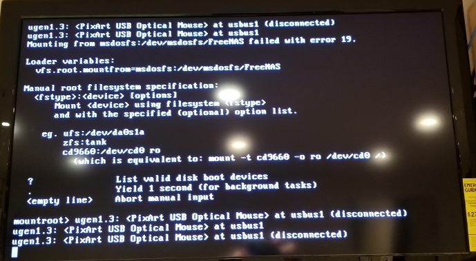

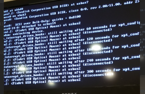

I have researched a lot about FreeNas and this is the best option I am looking for. So with that in mind I would like to turn my Dell Studio 540 into a Nas. Nowhere I have found says Ican't do it. So, why is the install so hard? :)
There are 3 issues that I currently have:
1. "run_interrupt_driven_hooks still waiting after 60 seconds for xpt_config"
And it sits there and does nothing afterwards...
2. In the attached photo you will sit it continue to say disconnected.
I even swapped different mice in different ports.
3. Manual root file system error:
Please help! Thank you!

I used Rufus to create the bootable USB drive from the iso that I downloaded from this site. In my first post I posted 2 images. The first being the mouse issue, which I still have. Then at that time of troubleshooting I removed the mouse and that is when I got the run error.

What is the drive controller? I suspect the xpt_config is more related to that than the mouse. If it is an integrated RAID controller, that could be an issue. It might be possible to flash it a different firmware that will make it perform better, but that has to be done very carefully.

Did you follow the manual information at 2.4?:
2.4. Installation Troubleshooting
If the system does not boot into FreeNAS®, there are several things that can be checked to resolve the situation.
Check the system BIOS and see if there is an option to change the USB emulation from CD/DVD/floppy to hard drive. If it still will not boot, check to see if the card/drive is UDMA compliant.
If the system BIOS does not support EFI with BIOS emulation, see if it has an option to boot using legacy BIOS mode.
When the system starts to boot but hangs with this repeated error message:
run_interrupt_driven_hooks: still waiting after 60 seconds for xpt_config
Go into the system BIOS and look for an onboard device configuration for a 1394 Controller. If present, disable that device and try booting again.
If the system starts to boot but hangs at a mountroot> prompt, follow the instructions in Workaround/Semi-Fix for Mountroot Issues with 9.3.
If the burned image fails to boot and the image was burned using a Windows system, wipe the USB stick before trying a second burn using a utility such as Active@ KillDisk. Otherwise, the second burn attempt will fail as Windows does not understand the partition which was written from the image file. Be very careful to specify the correct USB stick when using a wipe utility!
This machine is over 15 years old but just to confirm nowhere in the bios is there an option for legacy.
The run_interrupt error was adjusted by me disabling the 1394 controller.
The system hanging I looked into. I can't get past the esc button to follow its next steps.
So that is where we stand right now. We are at the mountroot hang.
What precisely do you mean? What happens at Steps 2 and 3 in the procedure? I'm trying hard to help you here but getting information is like pulling teeth...
RobbieG1977
Jul 20, 2018
19
In your above post I clicked on the link to " Workaround/Semi-Fix for Mountroot Issues with 9.3." In that article in said you will see the a grub option for like 5 seconds. Hit ESC on the keyboard to bypass the grub options. So I can't get past step 1 because step 2 and 3 don't appear. I thank you greatly for your help. Sorry I don't seem informative with my answers to you.
