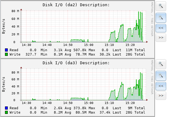

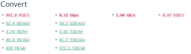

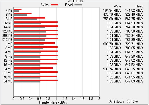

All, i wanted to give an update after Swapping the H700 our for an H200. We've been able to successfully seed TB's daily! Im talking 60+ TB's.... Im now at the limit of the 10Gb NIC in the FreeNAS. I'm currently doing testing on Aggregating connections to see if i can get multiple streams to eat up 20Gb of network. The beauty of this setup are the disks.. they are barely being hit with all that traffic. They are max 250MBps disks and running at about 80 with these tests.
Again thanks for the input and help! This turned out better than we expected.

Glad this is working out for you. Did you set it up with RAIDZ2 for resiliency, do any of the other tuning, or is this just "out of the box" performance with the reflashed H200?
I havent played with the different raid sets yet today. One of the two NAS's became available for testing and i didnt want to destory the data set until the DPaaS Team gave me the go ahead. Once thats good ill destroy the set and start messing around with it. This is Out of the box Stripe across 12 disks with the H200
