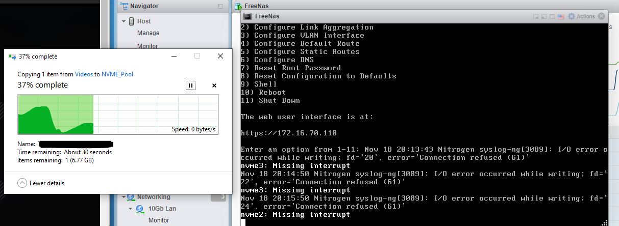

So we get booted up without issue now, but same issue, after a short burst, it stops dead... after a short while, it jumps into life, only to stop again... the dips in the attached chart line up with when we get the errors on the console.

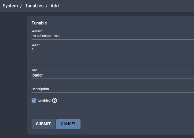

Try adding this tunable as a type of LOADER with the other settings still in play:
hw.pci.enable_msi="0"
Like this?
It got further into the 11Gb test file but still stopped twice along the way.. Do i need to reboot for it to take affect?

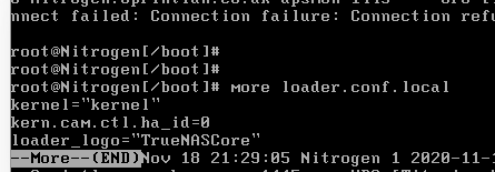

From the VM console, edit the file /boot/loader.conf.local and remove the offending line.

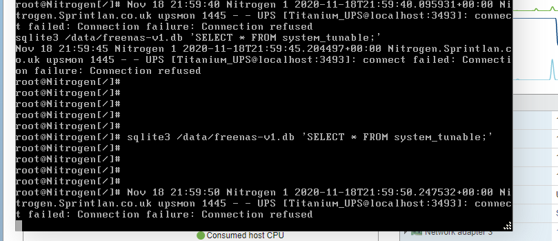

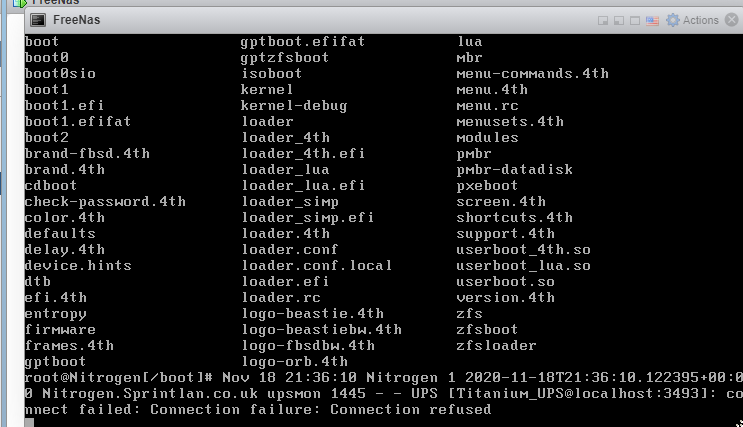

The file looks to not have anything in there? Am i looking at the right file? Also checked loader.conf and while theres more in that, the hw.pci.enable_msi="0" line isn't... Its difficult as every few seconds I get an error splashing over the page because it can't connect to the UPS. Could it be in any of these?

Looks like they're in the config DB now.
List your tunables:
sqlite3 /data/freenas-v1.db 'SELECT * FROM system_tunable;'
The first column is the ID - disable the offender:
sqlite3 /data/freenas-v1.db 'UPDATE system_tunable SET tun_enabled = 0 WHERE id=X;'
Sprint
Mar 30, 2019
72
List your tunables:
sqlite3 /data/freenas-v1.db 'SELECT * FROM system_tunable;' | cut -d '|' -f 2,6 | sed s'/\|/ /g' | awk '{print $2" "$1}'
Disable the offender:
I'm getting a "error: no such table: system_tunable". I had found that and tried that myself, would the path be different as this is TrueNas now, rather than FreeNas?
