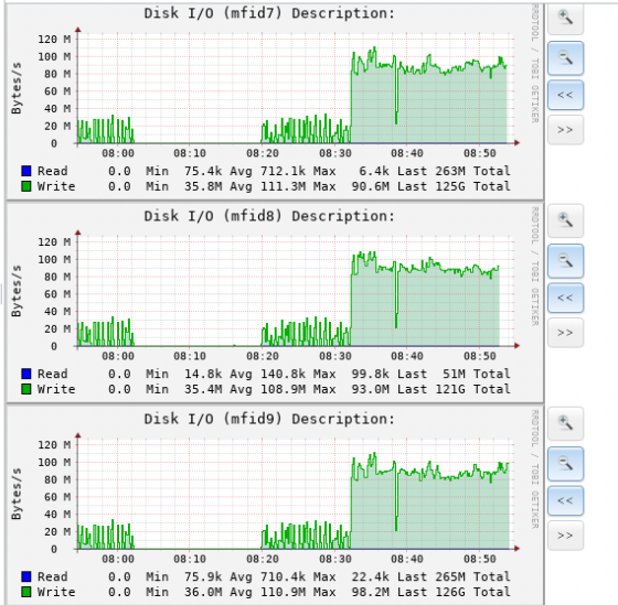

Removed the cache drives and now sustaining 9.3Gbps network traffic to the box...
That is really good, but you should still be using RAIDz2 to have some level of redundancy. Safety first.
Lovely results, suggests that the 960 EVO was just overwhelmed. Was it a PCIe card or an M.2 on an adapter?
(Don't let this dissuade you from getting the H200 and recreating the setup properly though!)
As suggested previously, you really need some manner of redundancy, even if it was only RAIDZ1 (Z2 strongly preferred given your drive sizes) because the time lost in having to re-copy all of these files is non-trivial. Safety first (and sometimes second!)

These are the kinds of numbers i was expecting!!! Our seed time went from weeks to 2 days!
