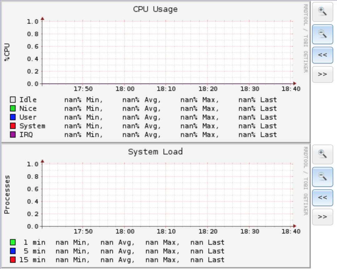

I have some problem:
1) Does my motherboard have IPMI? How can i use it?
2) My graphs report are empty, how can i solve it? All sensor are working, my system show me all report data in the process report display but i can't view it from the graphs...

pirateghost
Unintelligible Geek
Feb 29, 2012
4,219
Like i have imagined! :(
I have buy another PSU and everything is work!
Which board did you get? Looks like the x10 has IPMI, but x9 appears to not have
