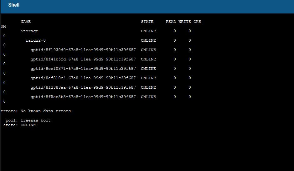

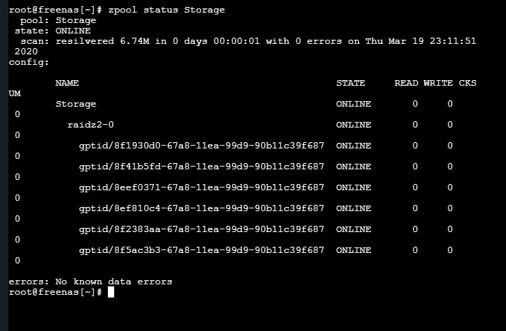

command zpool status shows no errors?

Can open the shell and give output of "zpool status" and check /var/log/messages for any errors? It could be the boot pool as well...

Thanks for your fast reply. when i type /var/log/messages, permission denied.
here a screencap from zpool status:

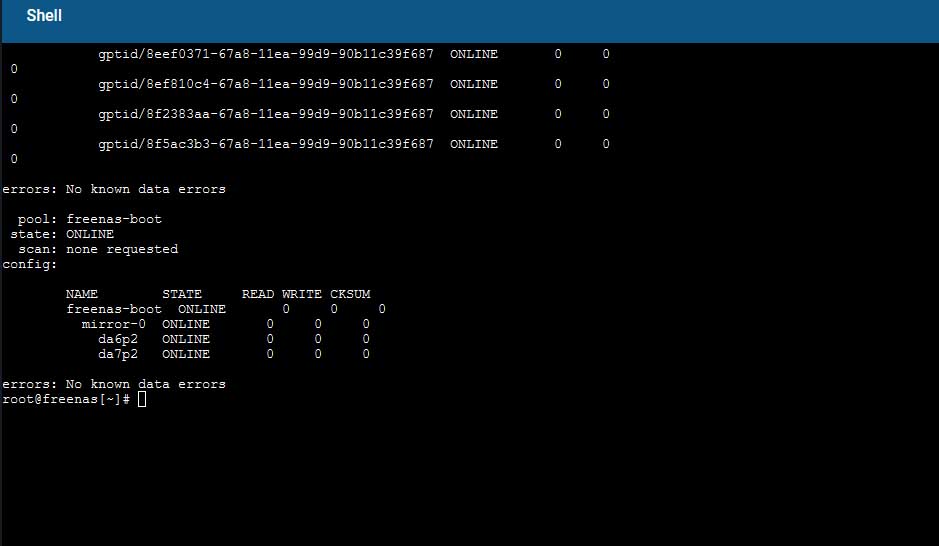

Sorry, I should have been more specific, "zpool status", since we want to see freenas-boot pool as well. And also "cat /var/log/messages | more" and look for any obvious errors.

Hi thanks! Attached the log as screenshots. can i export it into a textfile?
at boot it seems that da6 has some problems!? Could it be that the HBA controller could cause the faults? because its higly unusual, if every disk is bad.

Kris Moore
SVP of Engineering
Administrator
Nov 12, 2015
1,471
I took a look, and the logs you sent show a ton of SCSI / CAM errors across multiple devices. That to me indicates some sort of controller or other hardware failure, not the disks themselves.

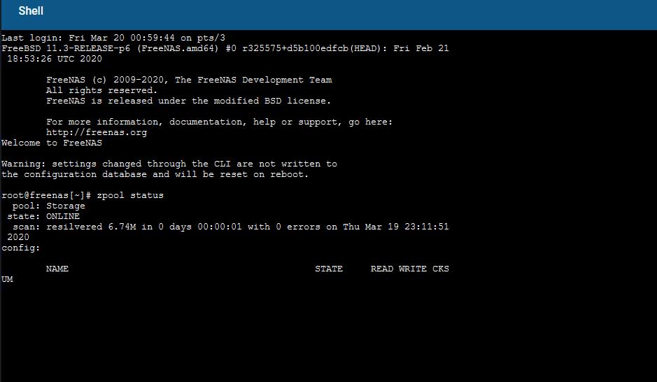

okay, thanks again. After installing the new controller and rebooting, after seconds following showed up :(

Kris Moore
SVP of Engineering
Administrator
Nov 12, 2015
1,471
Ram, Motherboard, could also be on the table. Again, check thermals though. I did have a similar issue with an overheating HBA at one point...
