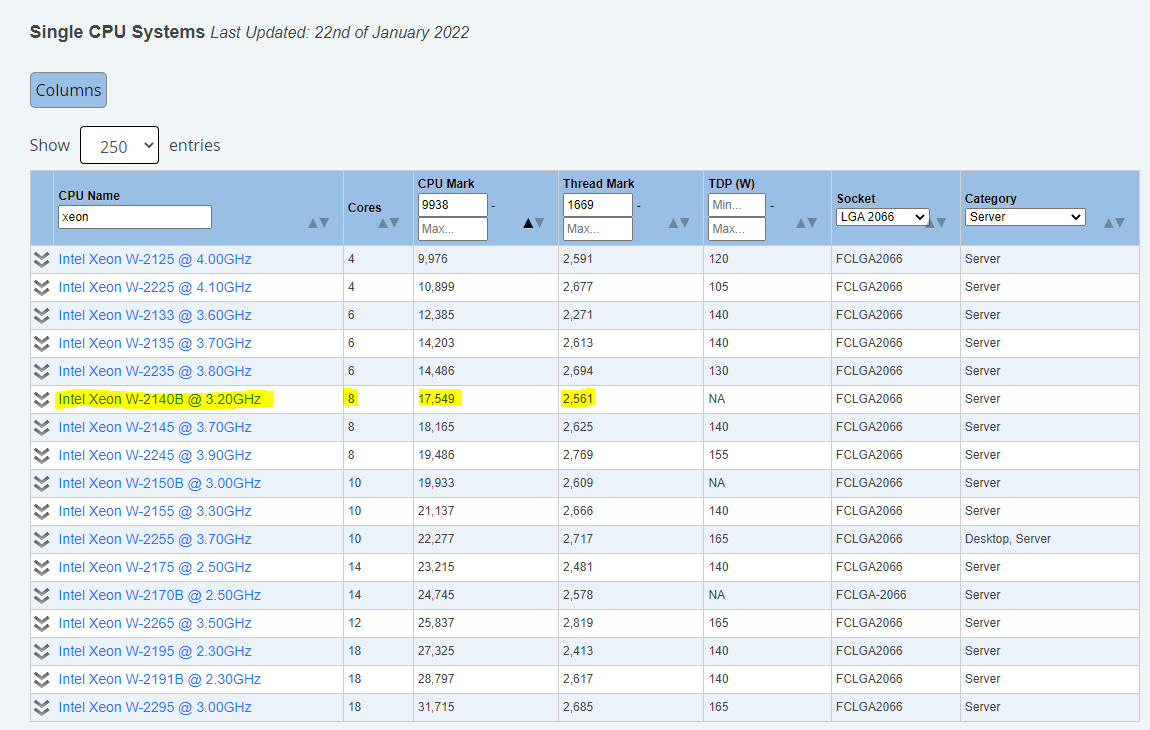

I have been looking at LGA-2066 and LGA-3647 CPUs, their CPU and thread marks, TDP, and overall performance here
I used the parameters of my existing E5-2650 v2 as a reference because I don't want to build a system that is less powerful than what I have now (if anything I'm considering new hardware to get similar or more power and added efficiency, in addition, to have a system that has a longer expected lifespan than my current system) and one thing is obvious:
This X9SRL-F and E5-2650v2 setup recommended by Chris is a huge bang for the buck for sure - too bad it is "getting long in the tooth" :)
W-2102/2104 (4C@2.9/3.2 GHz) is indeed dirt cheap, and Chinese sellers offer "retail" (non ES/QS) W-2140B (8C@3.2 GHz, 120 W) under $150, which looks very sweet. As expected, it gets less interesting higher in the stack and for Cascade Lake Xeon W-2200.
Yeah, I saw good deals on the 2140B, and it seems to be in a sweet spot in terms of performance (passmark of 17,549 vs 9,938 of my current setup)
