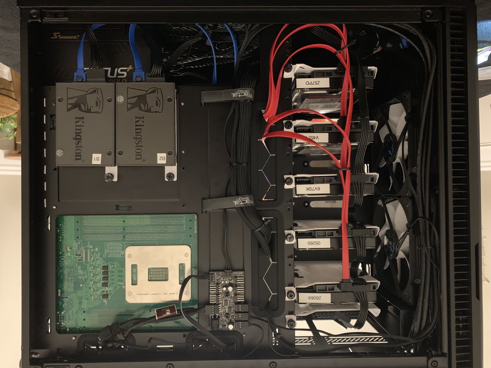

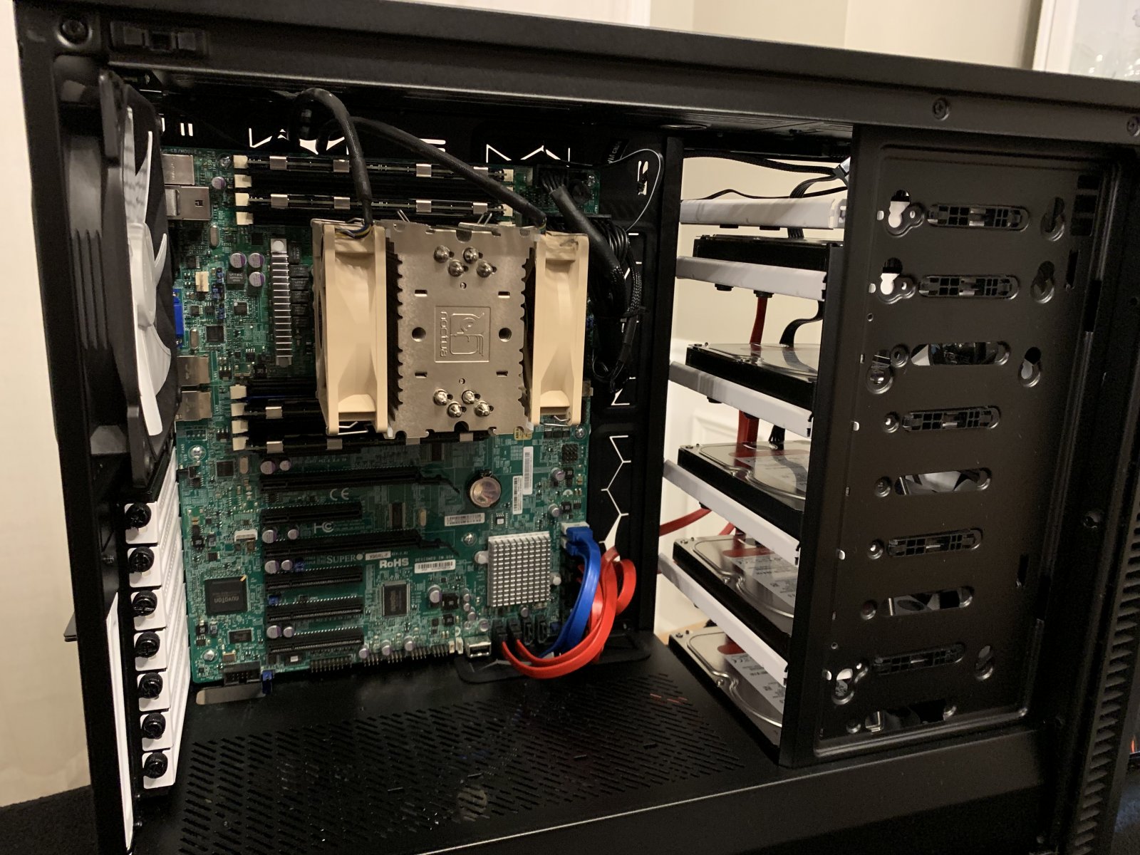

Build update:
I just finished installing the drives.
I ran 5 passes of Memtest86 and memory seems to be OK.
It is taking shape (images attached).
I'm downloading FreeNAS and installing tonight.
ali_v001
Aug 10, 2020
37
What cooler did you go for in the end? Any issues I've gone for the same board and also a fractal case. Any issues mounting the motherboard etc? Very similar setup
racielrod
Mar 3, 2018
74
I'm using this one:
No major issues so far, very quiet and keeps everything cool. I installed it more than a year ago, so I might be forgetting details, but the installation was straightforward.
The only nuisance is that the cooler covers the inner ram slot on each side. I'm not using these slots, so not a big deal to me. And even if I were, I don't see myself swapping memory often enough that this would be an issue.
This setup is rock solid, no issues after a 1+ year of running.
