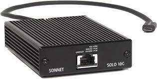

Sonnet (https://www.sonnettech.com/) also carries a selection of products for connecting thunderbold ports to ethernet networks. I've found their 10Gbe products to be solid (I've no experience with their other products, but suspect the build quality would match).

Yeah, I've seen it. As well as OWC, Startech, etc.
They all have complaints of overheating and dropping connection when in use for longer than 5 minutes.
There is no reliable external 10 Gbe adapter on the market right now, hence this topic.

ALL of them, really? I can imagine there may be heat issues for bus-powered 10GBase-T adapters; less so for bus-powered SFP+ adapters; and at the very least PCIe enclosures, with their own power supply and their own internal cooling fans, should be reliable. (Yes these are bulkier than a Mac mini…)

Yes, because there will always be doofuses using them. As @Etorix mentions, there's no reason that this has to be the case. Buy a properly ventilated device (not a plastic dongle) and, if need be, be prepared to ensure cool airflow over it. I'm happy to blame both vendors who fail to make suitably self-cooling gear and users who can't be arsed to understand that energy-hungry chipsets need cooling. I've used OWC and one of my companies is actually a Startech reseller. As long as you understand what you're buying and deploy it appropriately, the products of theirs that I have used work just fine. But yes you are absolutely going to get goobers who just buy random stuff and think "oh the fins on the side are just there to make it look cool" rather than realizing that it's an indication that it struggles to keep a reasonable temperature, and then post negative comments. A device that consumes watts tends to convert watts to heat. Plan accordingly!

From a little research, Sonnet dongles (with ribbed fins) run warn. QNAP T310G1S / T310G1T dongles have an internal fan, which a French reviewer measured at 44.6 dB at 1 m. Ouch! Choose your poison.

Make sure the airflow is flowing along the fins. I looked at some images of one of the Startech units and there was a casing that had fins (possibly vented) on two sides, and it isn't entirely clear what is going on inside. If you can locate a teardown image of what it is like inside, that knowledge would be very helpful to selecting the best strategy. Or a FLIR camera to find the warm spots. Or even just the back of your hand. It may be obvious, and if so *great!*, but the bits that get hottest fastest need the best airflow over them.
The Startech unit seemed like the worst of the ones I saw, it appeared to be probably molded plastic with only the fins on two sides.
Hard to cool, because you probably really need airflow coming down both of those sides IMO.
This one looks like extruded aluminum, which is likely to give better heat spreading results:
And these two look like someone put some actual time and care into venting and cooling considerations.
None of this implies anything more than my superficial glancing at a bunch of images to pick some interesting bits out at first impression. The ones with significant fins or venting win only because I am more convinced I can "fix" cooling problems with a fan. It is specifically not a purchase recommendation because I have no idea about the chipsets used etc.
