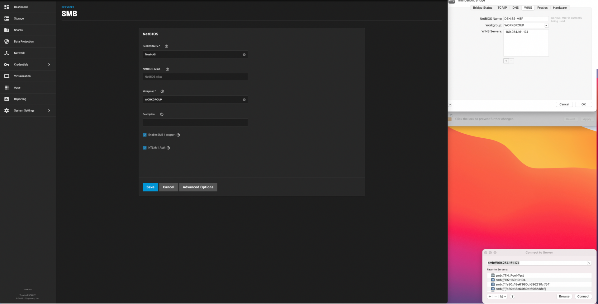

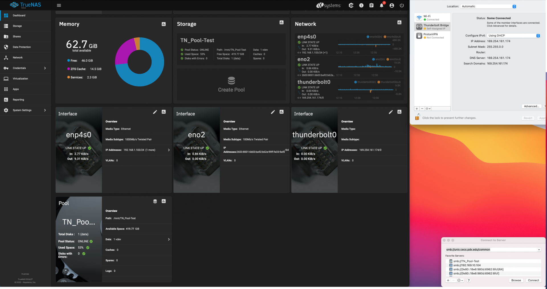

But then I got distracted/curious about something that I didn't expect to see/work, my motherboards Thunderbolt ports. When I was messing around with the "Configure Network Interfaces" on TrueNAS CORE, I noticed it detected my motherboards Thunderbolt ports but that was pretty much it, I couldn't see it anywhere in the GUI. But after switching over to TrueNAS SCALE for some VM stuff I was testing, the Thunderbolt ports were not only detected, but displayed in the GUI and detected by my "Thunderbolt Bridge" on my Mac system.

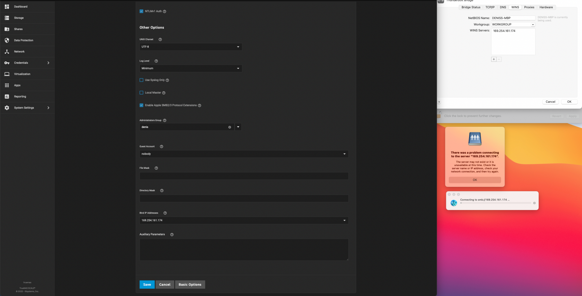

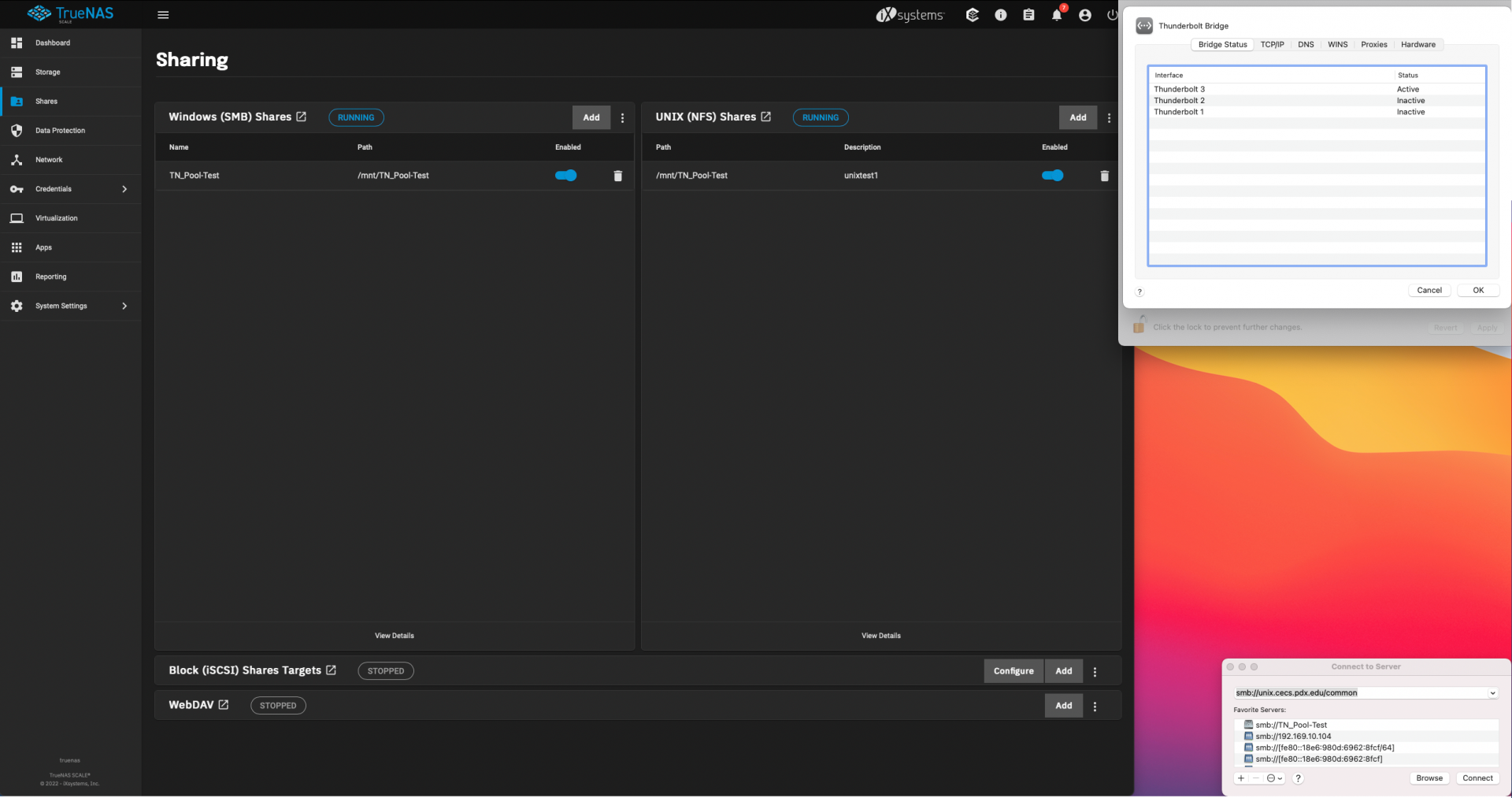

So, I thought, maybe I could somehow manually assign an IP for the Thunderbolt Bridge and point the SMB share towards it, and connect via Thunderbolt? So far no luck.
Thanks!

I'll preface my response with "I don't actually expect any of this to work".
I can see a few problems with what you shared...
You don't have a media type for the Thunderbolt interface (maybe that matters, maybe not).
The IP address assigned is an automatic one which won't be routable or sane to other computers trying to reach it unless they also have an address in the 169... range. (certainly worth trying to change it manually to something that you can work with like 192.168.x.y, but not the same subnet as your primary NIC... how are you connecting the MAC?... all thunderbolt systems have a Thunderbolt bridge, so I doubt that you are actually "detecting" the Mac from TrueNAS)
A TrueNAS Server (as far as I am aware) is not set up to perform the duties of a WINS server. (I don't see the value of specifying it as one on the Mac).
