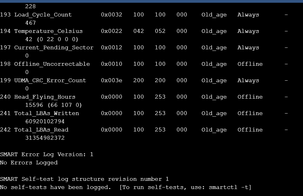

At this point I'd go through smartctl -a /dev/{device} for every drive in the pool and see what is up. Specifically I'd look for any failing smart tests. If you've never run any smart tests now is a good time to do a long test on those drives. To identify failures look for actual test errors but also look for values > 0 for the following lines.
  5 Reallocated_Sector_Ct   0x0033   100   100   010    Pre-fail  Always       -       0
197 Current_Pending_Sector  0x0012   100   100   000    Old_age   Always       -       0
198 Offline_Uncorrectable   0x0010   100   100   000    Old_age   Offline      -       0
199 UDMA_CRC_Error_Count    0x003e   200   200   000    Old_age   Always       -       0
OK i will do this, but just let me try the different hardware to recognize the pools first, i would like that first level of comfort. Here is a screenshot of da0 which is one of the disk

I would suggest you do this step as soon as you're able. Running the smart tests on your drives may tell us how many are failing or having issues etc.
How are you accessing your terminal? If you're doing it via the GUI could you just highlight the text and copy-paste the values into these forums? It'll save you having to take so many screen shots and truncating results. For example, the image above doesn't include the full output such as test results, or reallocated sector count. It really is best not to truncate information where possible.
i am doing it via GUI and i have tried to highlight the test and copy-paste to a note pad but it does not work, no option to do that.
1. highlight the text on shell in GUI, right click to copy then right click to paste here, which i can't seem to have option. i am using chrome.

i am not sure how to do long test in parallel therefore i am doing it one by one. On the output being truncated i will learn to scroll to copy. Perhaps after this drive of da0 has completed i will do short tests
Issue the command for each drive individually. The tests run int he background. If you do them 1 by 1 it will take many days. if you do them in parallel they won't take nearly as long.
1kokies
Oct 7, 2017
138
OK let me first learn how to copy & paste the whole output, i see what you mean by truncating, totally agree data are left out.
1. i use new GUI in shell i don't have option to copy & paste, even using Firefox nor chrome
2. i use the legacy GUI in shell, i don't have option to scroll, so i use the PASTE button, which returns below

there are much more information with the new GUI shell, let me try again.
1kokies
Oct 7, 2017
138
managed to get the output copy with SSH/Putty, think this is better. thanks Philo !
