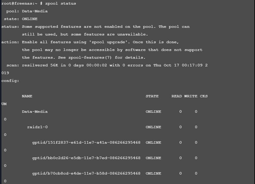

Please help me urgently, greatly appreciate, all data are in this pool. In pool import option, Data Storage pool does not exist.
i swapped all ports, changed raid cards, re install 11.2 U6 to upload old config, all came back with the same results. The disks are detected with serial numbers but the pool is not.

Hi @1kokies, would you mind please checking my suggestion above and include exact model numbers of all potentially relevant hardware if you haven't already done so? We can take guesses as to what is going on but knowing exactly what you're using would speed up the process. For example, how are your drives connected to your system? What model of RAID card are you using (is it that SATA card you referred to)? Is it flashed to IT mode? What Firmware version?
Also, the output of zpool status would be very helpful. Also, showing us what disks are recognized by the os would be useful; you could check the Storage->Disks screen perhaps.
Final question, do you use encryption?
I know I asked a lot of questions here. If you could go through and answer each of them someone can likely help you get access to your data back quicker. :)

proc: Xeon E2609 V3
mobo: Asus X99-e WS/USB3.1. Using only the 8 sata ports, not the AS Media ones
raid card: 1x 9220i (LSI i think) flashed to IT Mode, all 8 ports are used, sata. not sure where to see the firmware but it may be 500605B 0-03CF-6840
hdd: 12 x ironwolf 4TB. 4xraidz2 + 4xraidz2 + 1slog128GB Sandisk for Data Storage. For Data Media 4xraidz1. All connected with sata via raid card and on board sata.
Network: intel 2x nic card, not using the onboard ones
graphic: nvidia card for console
rams: 112GB ECC
power supply: 850W

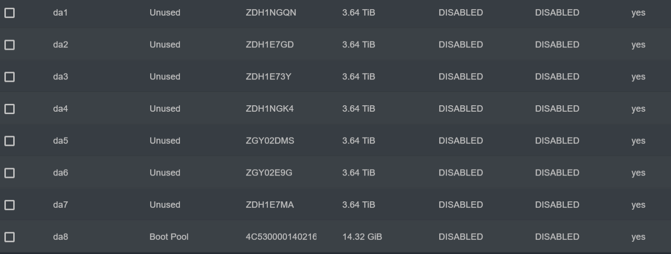

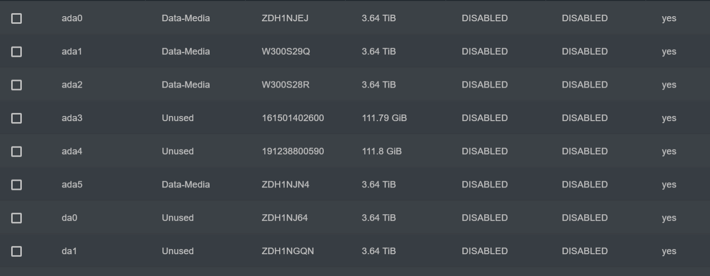

hard disks drive bays: thermaltake 3503
encryption: none

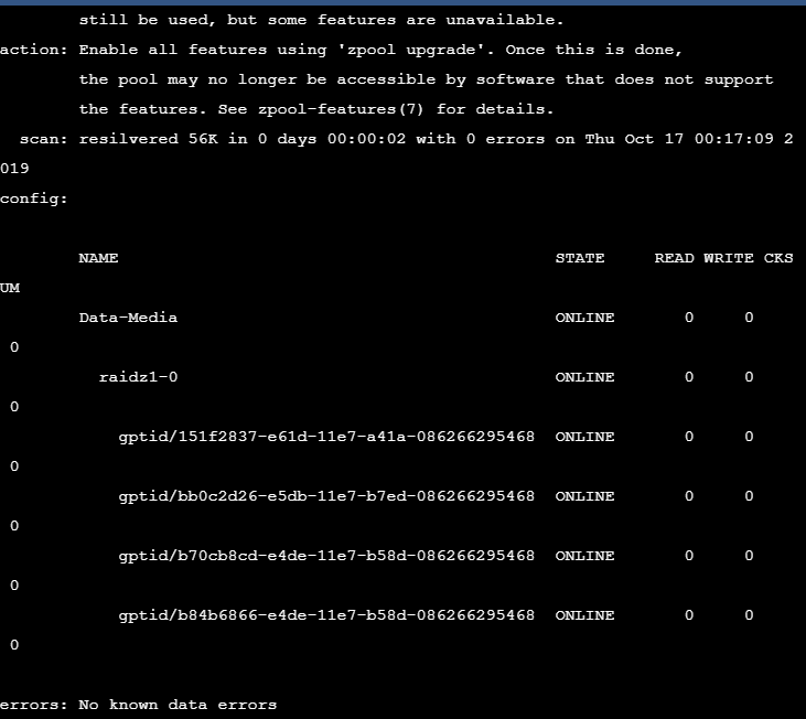

again please help. screenshot as requested.

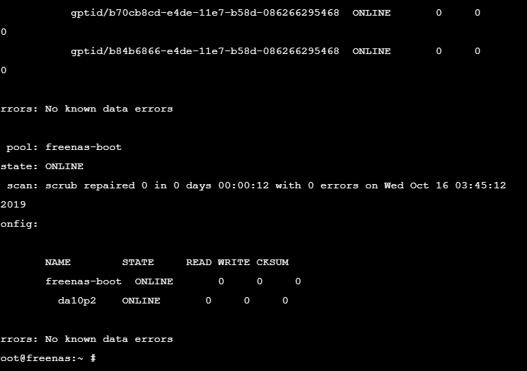

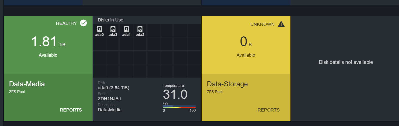

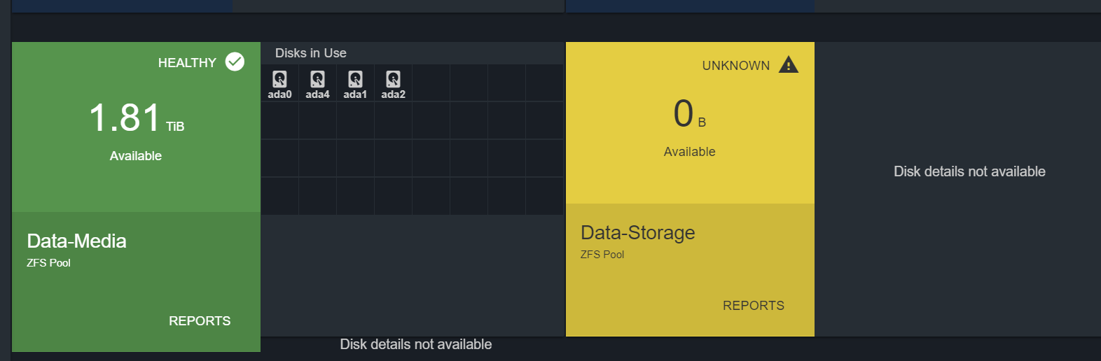

screenshot of pool unknown, please help guys.

Your screenshot seems to truncate a lot of information. Is there any way you can copy-paste the entire output of zpool status? Any truncated results you post here may delay anyone's ability to help you due to going back and forth trying to get all of the information.

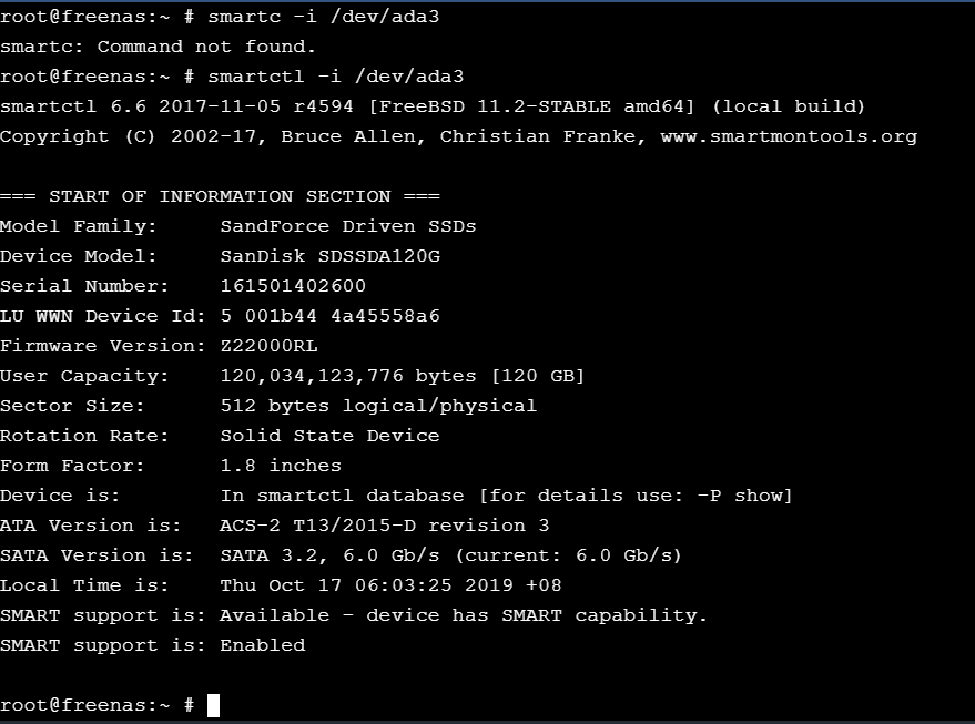

From the looks of it your slog devices are probably those 111GB drives currently at ada3 and ada4. Could you give the output of smartctl -i /dev/ada3 and smartctl -i /dev/ada3? Please don't truncate the results. Feel free to copy-paste, and if the screen scrolls when you hit the command please scroll back to get the full contents. You can paste them in code tags like this.

Also, looks like your data drives are da0-da7.

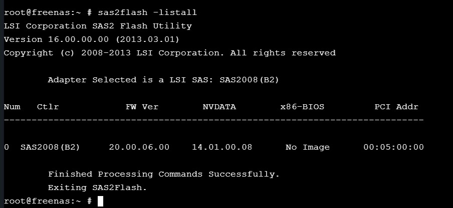

What is the output of sas2flash -listall?
In general, what I'm looking to discover is what devices your system expects to be in the pool and which are malfunctioning. If it is the SLOG device it may be as simple as removing the bad SLOG device and adding the new one again; though this will depend somewhat on the situation.

yes the slog's are ada3 and ada4. ada3 is the bad one based on the serial #.
zpoolstatus attached 1&2 screenshot
smartctl -i for ada3 & ada4 attached screenshot
sasflash -listall attached screenshot
yes, my Data Storage pool is da0-da7

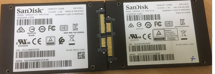

Okay, so my guess is that one issue MAY be that the two SSDs appear to be different model numbers. This could prevent the new one from replacing the old one. No worries though; what we will do is remove the old one from the pool and add the new one.

Both the SSD's are bought for slog and they are identical models. old + 0, new + 0, old + new, 0+0=pool unknown

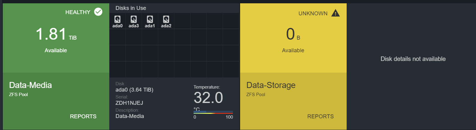

the slog ssd & dashboard
