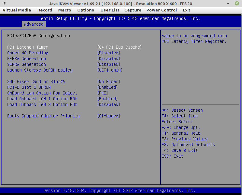

I already discovered tips like this one but I'm not sure that I have such entries under PCIe/PCi/PnP Configuration. Please, take a look at attached image how it is here.
Well I just poked around in the BIios on one of mine - we have the same information displayed, and, if anything I would say that the bios seems to be set in the closest set of options that appears to match the method we are discussing.

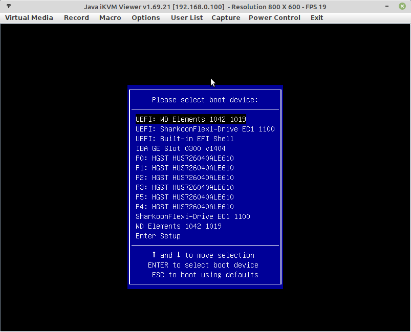

Well, with F11, I get device list to boot from, which is basically the same thing as if I enter BIOS and set boot priority device. Not much to do here, I can select Sharkoon USB stick with TrueNAS installer and install it again to PCIe device, but I don't see a point of doing that, as there is no PCIe device on the list to boot from. See attached image. There is WD Elements that is USB-HDD drive in external enclosure where I installed TrueNAS and running from now. HGSTs are obviously spinners on MB SATA ports and IBA device is network as far as I can tell.
