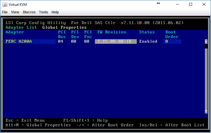

When the server is booting, you have an option to hit Ctrl+C to see the LSI info.
Ahh, okay. You don't need to hit "CTRL + C" to enter the H200 Configuration Utility. Some people prefer to actually not have the BIOS on the HBA (so it boots a little faster). I like having it there so I can see it detecting the drives and stuff, but rarely ever need to enter the Configuration Utility.

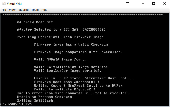

any ideas?
I skipped one since it's v7xxx. I think that could be it?

Out of curiosity, was this attempted after a reboot (would be best to if you are starting over)? This link, has more details and goes so far as to write the "sbrempty.bin" (megarec -writesbr 0 sbrempty.bin); which I have only had to do on rare occasions.
Worst case give those instructions a looksy. Keep in mind the C2100 does not have UEFI so instructions pertaining to that can be ignored.
It was after a reboot. But the USB stick was a turd. Put the same file on another USB stick and it installed without a hitch. Been up and running since last night.
