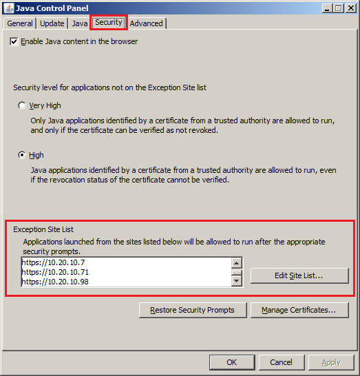

Yep, I use IPMI all the time. From the initial FreeNas install (via Virtual ISO) to Powering On or Off, etc.
Since it is Java based, you will need to add the URL to the "Exception Site List" in Java (Screenshot below). Between the FreeNAS Web GUI, IPMI and Putty (What I prefer for SSH) you would rarely need to ever physically go to the machine aside from when actually working on the hardware.

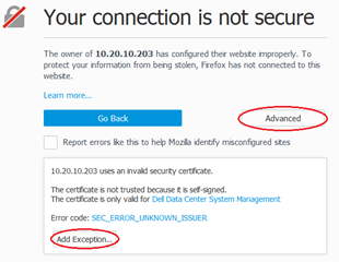

You may be prompted about an "Insecure Connection"; Just Click/Select "Advanced" then "Add Exception":
Then in the "Add Security Exception" Dialog; Click/Select "Confirm Security Exception"

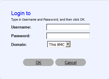

From there you should then be prompted for Login:
Let us know which parts you are not able to get to. :)

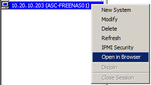

Yep, that is fine I was going to mention to try and use that as well. So the fact that you are able to connect to it from that is a good thing. Within the SuperMicro IPMI View, what happens if you Select then Right-Mouse Click on the Server and choose "Open in Browser"?
I get the same error, Can't connect.

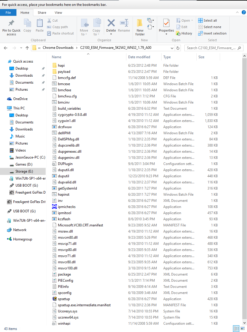

I didn't get any of those prompts with firefox or Chrome.. Firmware is 01.78, and IPMI is 2.0. As I stated a few replies back, I have not flashed any firmware, bios and the others you suggested. Maybe that is why I am having issues. I did start the download process of the bios and firmware, but for some reason I don't see these few items in step 3.
In the extracted "pec2100bmc179" folder
  • Navigate to the "SOCFLASH\dosflash" folder
  • Copy "DOS4GW.EXE" and "socflash.EXE" to the "BMC166" folder
I've found the other part for 166, and the .bat is already created. I think I am having more issue than I should lol. I know it's operator error, HAHA.
