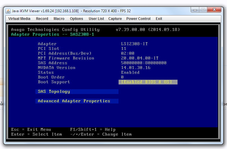

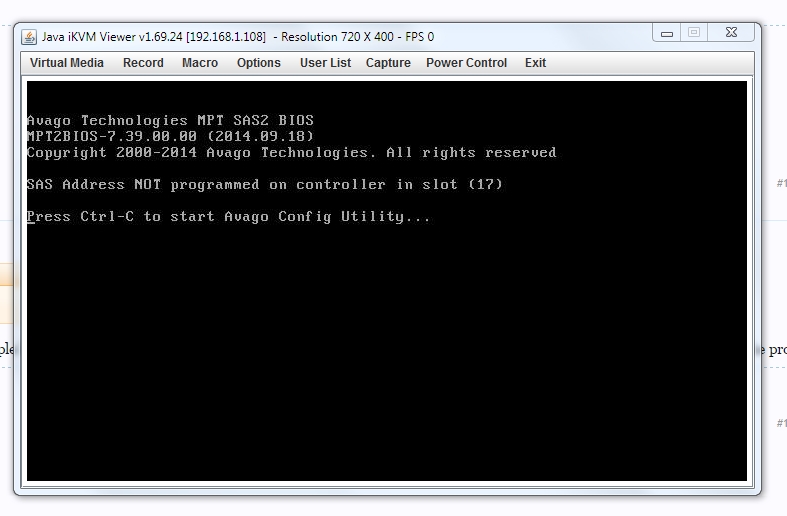

OK , I really think I screwed up this time. When I was flashing my SAS to SATA I screwed up and only entered 8 numbers instead of 9 ( I only wrote down 8 numbers) I though I could go back and get the numbers and start over....No such luck :)
What can I do now ????
solarisguy
Apr 4, 2014
1,125
@Jeff Lamer, please try adding "0" as the ninth digit (or if that fails due to some check-summing keep trying with "1", etc.).
And please let us know how it went.
Jeff Lamer
Nov 17, 2015
121

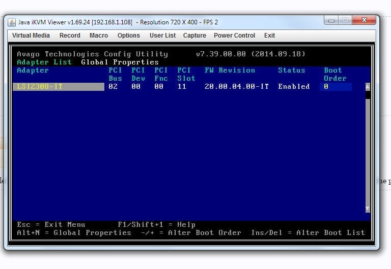

Thanks....That worked...plus I figured out the whole nine digit thing 0:1C8C4900
Now to figure out how to flash my SATADOM and MEMTEST86 :).

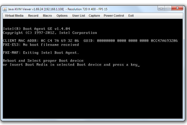

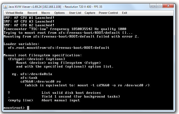

Now I have this error after I tried to virtually flash FreeNas. It all looked great until the reboot :(
Please Help !
A bit more info
solarisguy
Apr 4, 2014
1,125
  1. Remove PXE boot option in BIOS.
  2. Are you using USB 2.0 or USB 3.0 port on the motherboard?
  3. Any USB options in your BIOS you can toggle? Look for xHCI or XHCI.

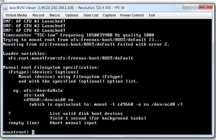

Ok, I followed these instructions. It took a bit but I got PXE boot option off on LAN settings and disabled XHCI. I was able to get Freenas GUI up and running until I rebooted !! Now I'm back to square one
with this Error
When I go into the BIOS the boot menu doesn't show my SATADOM. Could it be that my SATADOM is powered from my power supply and not my Motherboard ? I did get it to load the Freenas a second time but upon reboot I'm back to the mountroot issue again.
Jeff

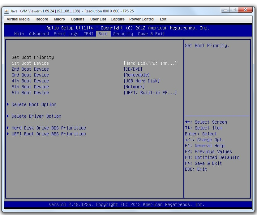

solarisguy
Apr 4, 2014
1,125
I am confused...
Could you please repeat information about:
  • source of the initial FreeNAS installation
  • destination media for FreeNAS (the media FreeNAS would normally run on)
  • boot sequence in BIOS
Jeff Lamer
Nov 17, 2015
121
I am confused...
Sorry bout that!
The initial source was iso on my computer that was virtually mounted to install
FreeNAS was/is installed on SATADOM . It the the only memory I have installed todate.

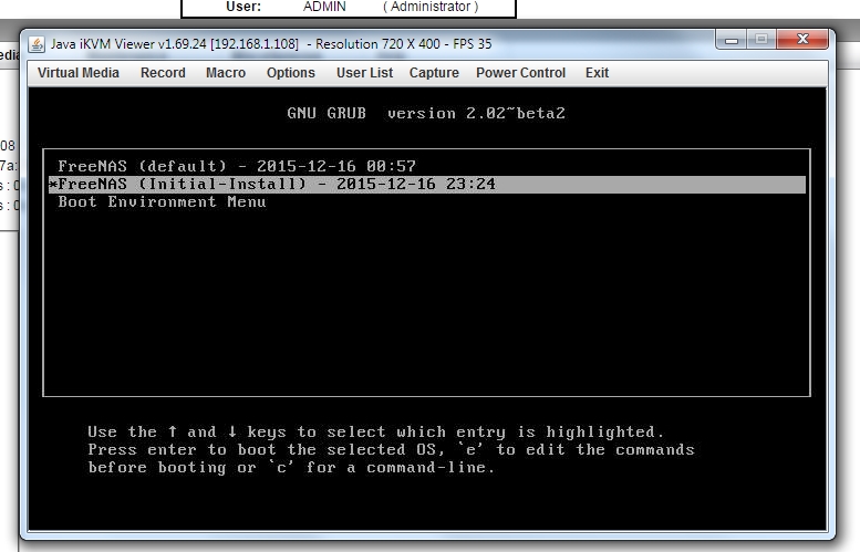

Boot sequence attached
I can't figure out the two different versions? It appears to be rebooting OK , But I am worried about future resets. It is currently using the (Default) Version.
How do I remove the second one? (Initial-Install) or is that normal.

Please do not remove (Initial-Install) !
That is an actual feature and the FreeNAS team is proud of it ! ! ! :D
In short, FreeNAS stores previous boot environments to allow for an easy rollback in case anything happens.
Long story is that you have to read the manual ;) http://doc.freenas.org/9.3/freenas.html

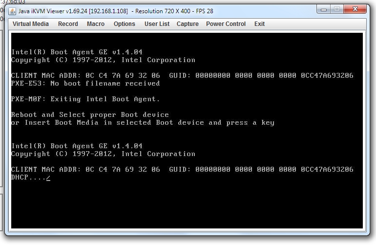

Still having Boot issue with startup not seeing my SATADOM. I left it powered all night (OK) today I powered off with button and rebooted.
I then followed the same procedure and it started up on the third try without any changes ??? What to do?
Jailer
Not strong, but bad
Sep 12, 2014
4,977
Is it plugged in to one of the Intel SATA ports (the white ones)? If not do so. Is it detected by the BIOS when it doesn't boot? Can you manually select from the boot menu option (F11 or F12 - can't remember which) when it doesn't boot?
If none of those options work and you haven't made a bunch of changes in the BIOS then I would look at n RMA for your DOM.
