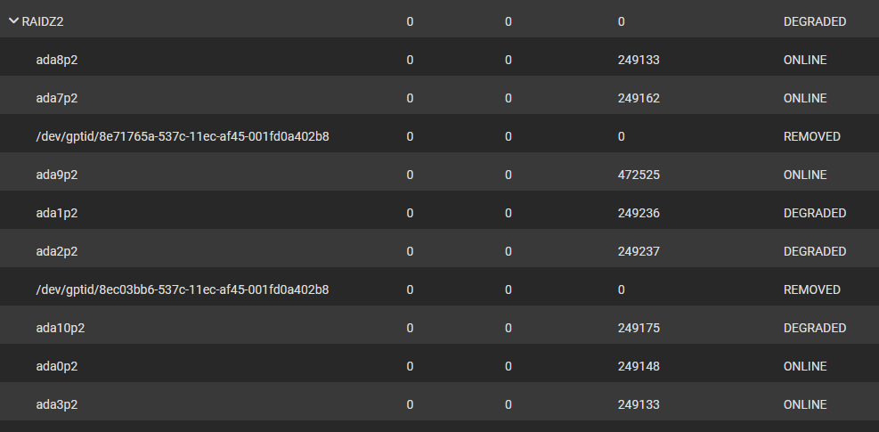

And while I'm still at it (resilvering...) please tell me, what are the chances for this situation within one hour: :oops:

Only gets worse... o_O
# zpool status -v
  pool: Pool1000
 state: DEGRADED
status: One or more devices is currently being resilvered.  The pool will
        continue to function, possibly in a degraded state.
action: Wait for the resilver to complete.
  scan: resilver in progress since Sat Sep 10 21:33:11 2022
        2.00T scanned at 450M/s, 1.40T issued at 316M/s, 4.41T total
        118G resilvered, 31.82% done, 02:46:20 to go
config:
        Pool1000                                        DEGRADED     0     0 0
          raidz2-0                                      DEGRADED     0     0 0
            gptid/8db9bb46-537c-11ec-af45-001fd0a402b8  DEGRADED     0     0 1.23M  too many errors
            gptid/8dc85dd3-537c-11ec-af45-001fd0a402b8  DEGRADED     0     0 1.23M  too many errors
            gptid/8e71765a-537c-11ec-af45-001fd0a402b8  REMOVED      0     0 0
            gptid/054365a1-3137-11ed-8d00-001fd0a402b8  ONLINE       0     0 2.33M  (resilvering)
            gptid/8f0c44a0-537c-11ec-af45-001fd0a402b8  DEGRADED     0     0 1.23M  too many errors  (resilvering)
            gptid/8f11d75c-537c-11ec-af45-001fd0a402b8  DEGRADED     0     0 1.23M  too many errors  (resilvering)
            gptid/8ec03bb6-537c-11ec-af45-001fd0a402b8  REMOVED      0     0 0
            gptid/8f188c7d-537c-11ec-af45-001fd0a402b8  DEGRADED     0     0 1.23M  too many errors
            gptid/8f1c2cc5-537c-11ec-af45-001fd0a402b8  DEGRADED     0     0 1.23M  too many errors
            gptid/8f6d7dbc-537c-11ec-af45-001fd0a402b8  DEGRADED     0     0 1.23M  too many errors
errors: List of errors unavailable: pool I/O is currently suspended
