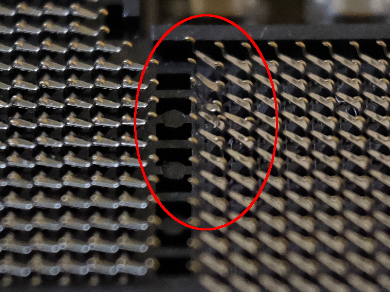

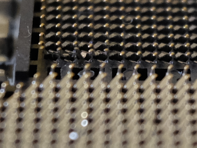

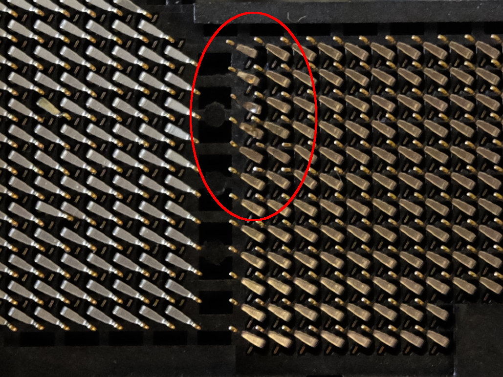

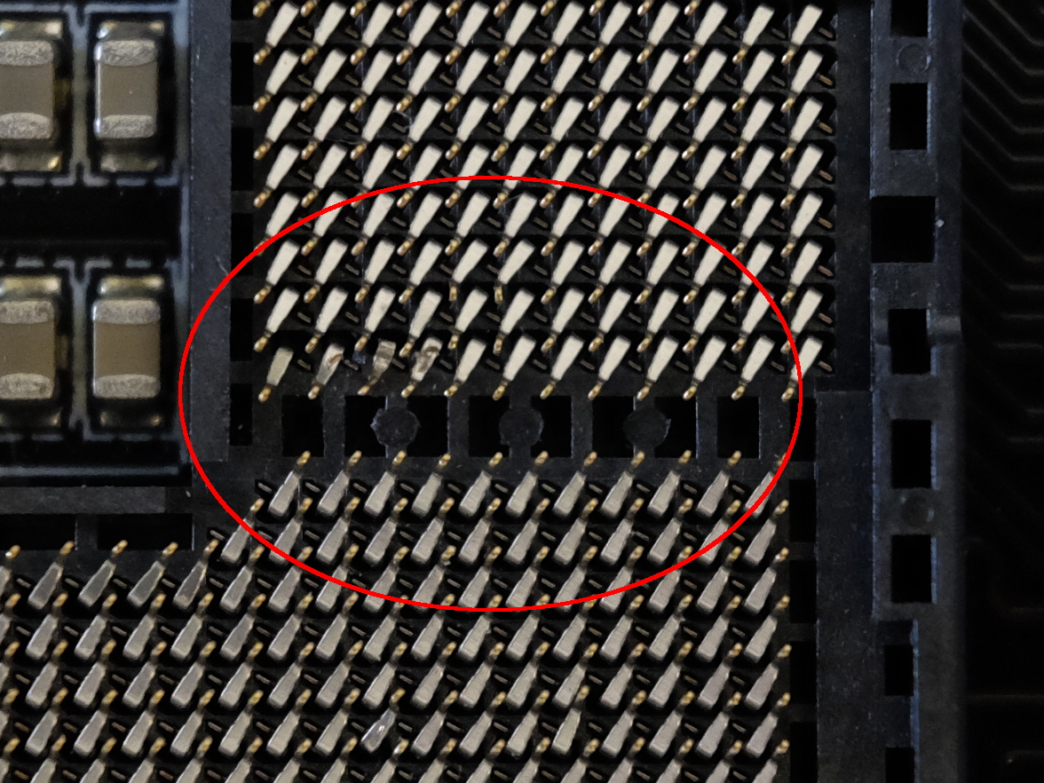

Hello together,
I'm a bit sad and I need some help of you guys... :( A few weeks ago, I bought a used Asus P10S-I motherboard to save some money (student...). When unboxing the device yesterday in the evening, I saw that some CPU-pins were bent. At this place, thanks to the seller...
I've tried my best to fix that in a work of more than two hours. Do you think this will work for the CPU? Or should I buy a new board to protect the CPU? :( It was a lot of microscopic work...
Thanks a lot for your help!
With best regards!
Bobbi

Well, I have to remark that all those pictures show exactly the same pins, but with different viewing directions. The rest of the socket is still fine.
Actually I don't know what to do. The processor for testing should be compatible with the board as well... I "only" paid 90,- EUR for the board, so the damage is not drastic. But as a student it is annoying nevertheless...

They are all in one location but you still have something like 4 pins that look a bit worrying.
If I take your picture:
index.php
If the upper left corner (in your circle in red) is at the coordinate 1;1 (x;y).
Then I find pins 3;5, 3;6 a bit off, you might get them back like the rest?
And pin 1;3 seems "weak" (like don't touch it anymore it might break)...
So again, I'd check the pinout of the socket for your CPU and evaluate the "danger".
I can understand that it's annoying when you get that for 90€!
What is the CPU you have, and how much did you spent for it?
I mean by that: you paid 90€ for the motherboard, you could get a 40€ CPU (Celeron G3900) and you could try it. If it works out, you can have a running system quite cheap.
If it's not working, well... then you lost 130€! which sucks anyway! :tongue:
Of course if you already have a CPU and you paid like 200€ for it, I think I'd get a new motherboard! :tongue: (and I think I would definitely try with a G3900 a G4400 and if it works I'd have a nice test and backup system!).
