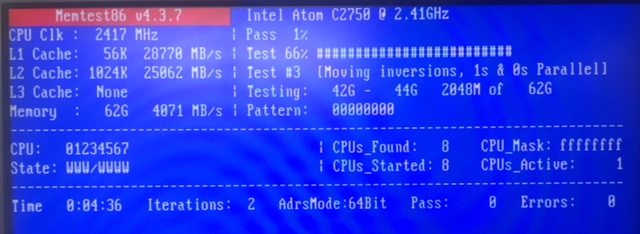

Use Memtest86, not Memtest86+. They are different and to my knowledge Memtest86 works better. I think the + version may throw false possitives.

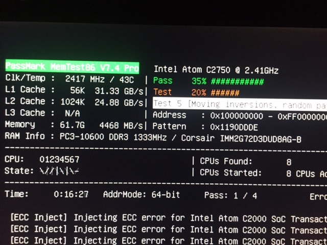

That's not the screen display from the Pro test ($39). You need to boot in UEFI mode to get it to run the latest version - 7.4 Pro - it'll look like this:
index.php
Allegedly you will be able to set it up to inject ECC errors also. I have been in discussion with Passmark as, while I saw the screen messages suggesting it was happening (see the last 1.5 lines above) I never saw any system response or other indication that it actually took place. Passmark has a debug file from me now to examine.

Memtest 7.4 pro running now for three hours - thank you! All 8 cores doing their thing without issues thus far despite ecc error injections and so on.

Passmark responded on the review of my debug file:
"Yes, it does appear that your chipset supports ECC injection. However, ECC injection has been disabled by your BIOS. Once it is disabled, it cannot be re-enabled until the next system reset.
You may want to check your BIOS setup to see if there is an option to enable ECC injection. Otherwise, you would need to flash a custom BIOS to prevent the ECC injection from being disabled."
There isn't such an option in my BIOS, nor I imagine in yours as they are the same MB. $39 blown.
