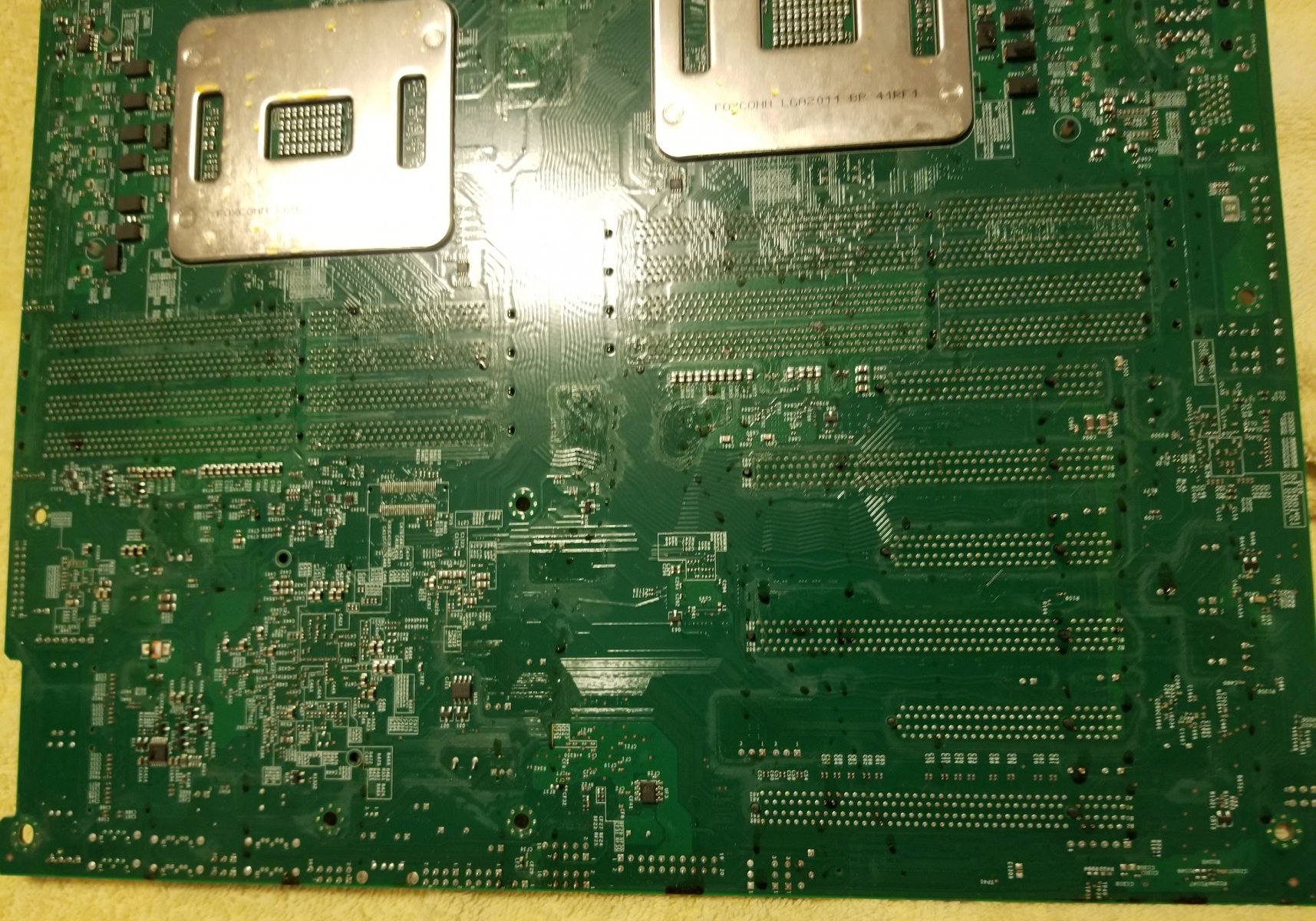

The answer was PEPSI!
See the attached picture.
Someone did it for me :)
The best identification method for the single bit ECC error is the BIOS SEL, it tells the exact CPU and slot. The MCA error message is not that easy to interpret.
The MB made a shower in the tub, alongside the MB mounting plate and now i have a 16GB ECC DIMM in the ultrasonic cleaner, the one with the MCA error. I have personally saved another 8GB ECC DIMM some time ago with the ultrasonic cleaner, hope it works this time also.
