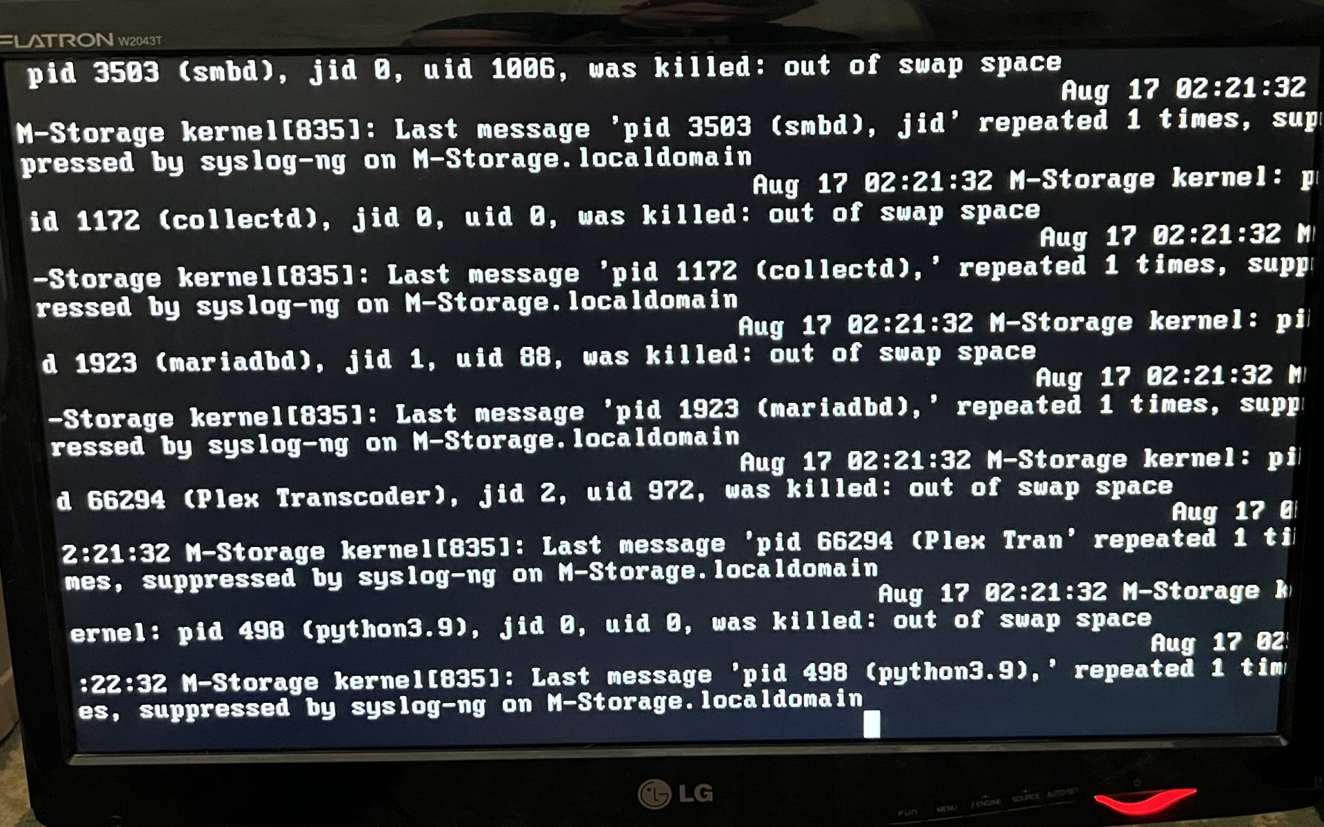

I noticed in the last few weeks that my Plex and qbit crashing (each has its own jail) at the same time. (I attach a screenshot)
Now if you look at the screenshot you will see that the error is that he has run out of swap but he has a lot of swap space, I checked and swap has never (in the last year) exceeded the 1GB out of the 2 he has, so this cannot be the problem.
