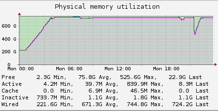

We are getting consistent memory leaks when writing large amounts of data regardless of the sharing protocol we use (ie same on iSCSI, SMB and NFS). We have a SMB share on 3 x RAIDZ vdevs. Its running at about 40TB used on a 150TB zvol. Dedupe and LZ4 enabled. When the writing is large (ie 1Gbps sustained). RAM is suddenly given up as per the graph below. When that happens the UI becomes unusable and the shares drop
and the network traffic dies:
Any ideas? Auto tune isnt set. Have tried it but it makes no difference.

That is a normal memory usage graph. The strange part is the sharp free of memory towards the end. What happens if you disable dedup and run the same test. Your system is larger than anything people run here so there might be done other interesting factors.

thanks Stux and SweetandLow. Interestingly Iget the same behaviour on other test systems in a virtualised environment and disabling dedupe reduces the severity of the issue, but we will still get it. Im relucantant though to disable dedupe at this stage. We operate two production systems running VMs (the system above is for backup) and they have Build FreeNAS-9.10.1. They dont have dedeupe and dont have a problem. The have mirrored vdevs which is the only notable difference.
On the backup system mentioned above we have multiple replications to it and two types of compression running as well as dedupe. Would vfs.zfs.zio.use_uma = 0 help? What is the effect? Would disabling L2ARC also have an effect?
